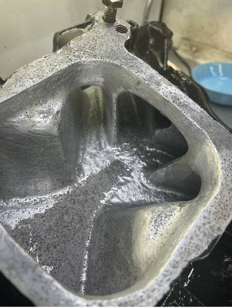

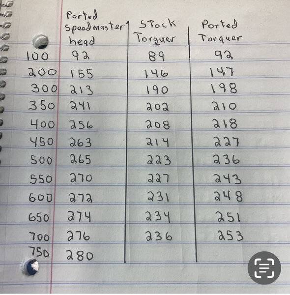

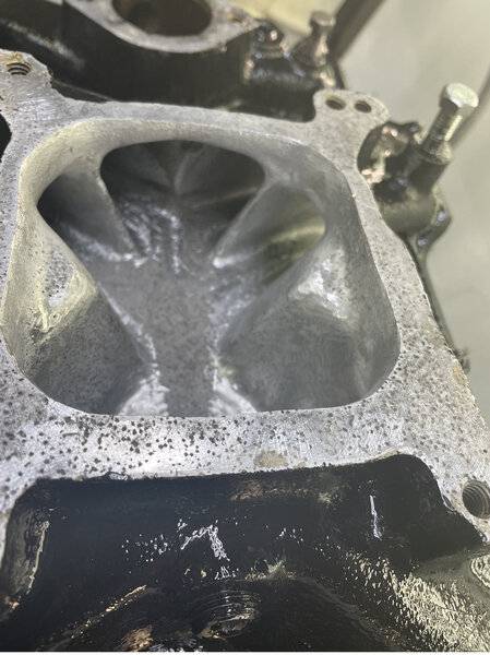

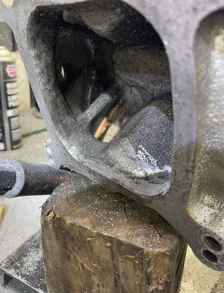

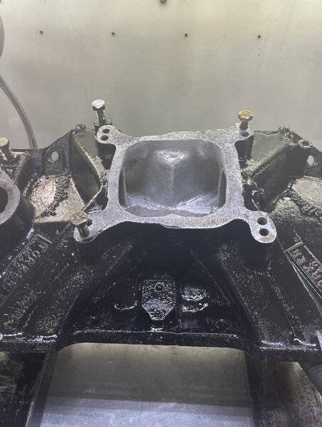

My son got this ugly thing on a 340 He bought years ago. Talking about an ugly intake. I swear someone buried it in their backyard for 30 years. All in all for the little bit of time I spent on it she ended up
Flowing pretty good.
Man i have never seen soo much pitting on a intake... nice job on the porting :)
Looks like it was stored next to the half-opened pool chemicals in a leaky shed next to a PG&E plant. Yikes.

PBR, what's your overall opinion of Torquer? they get a bad rep but I also figure its early technology. As I understand it though they were a low rise single plane designed to fit under a hood of a street car.
I’d like to work on a second generation one to see if they are a hair better. But then again I’d like to play with an old Port A Sonic too. I ran 11.82 with one out of the box on a 340 back in the late 1970’s.
