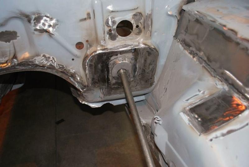

The shaft is just a 3/4" steel bar and if you look online (Speedway motors) you can find a bearing and carrier that will fit and you would just have to attach it to the factory firewall bracket. I went a little different route but the theory is the same.
attachment.php
Here's the bearing I used from speedway, there are several out there, and you'll need a couple shaft U joint couplers.
