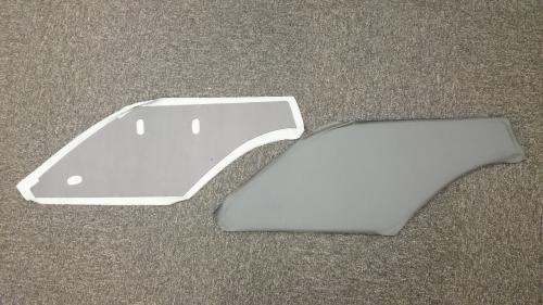

So I ordered a headliner kit (67-72 5-bow Dodge Dart) from Year One recently expecting a simple five-bow headlining kit, which should be just the headlining by itself.
But a three piece kit arrives.
The main top section doesn't seem to have extra material for the c-pillars, but instead it has a pair of thin cards that are trimmed in the same perforated material (I've included a photo).
Is this normal, or am I freaking out about nothing?
I got those same exact panels with my 67 barracuda notchback headliner kit. They didnt fit my car, and unfortunately i bought it with the headliner already ripped out.
I got spray glue in side boards, and my headliner has enough material to come down on the sides.
Dont think this helps you, except that these are prob the finish panels for the C pillars.
Matt

My main issue (besides these boards) is the headliner is the wrong shape as well. There should be two wings of material for the C-pillars but it seems to just be a massive rectangle.

okay so it turns out I was just being paranoid and the headlining was right. We bought a second headliner off ebay and it certainly looked more correct.
I found an interior place nearby and took both headliners to them. We laid out the year one kit first and then laid the second one over the top. Basically the second kit fitted inside the lines of the Year One kit so we could use either to do the job. The side boards in the picture above go behind the c-pillar headlining to fill out the section (why couldn't anyone tell me that?).
Anyway, we ended up using the Year One kit because the quality was better and they trimmed away the excess - and there was alot of excess.
