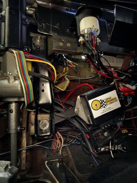

Kent, I'd probably look at one of them under dash electric assist kits. That would save all the room under the hood. Just something to think about.
I have never seen one of these kits. Any references? I will search by references help.
After some research.......
I will look into the EPAS and Flaming River units
It's certainly worth looking into. Might not be your cup of tea, but you never know.
I would love to not have to move the engine mounts, remove headers remove steering box, install new brackets and find pulleys. I have not read any negatives about these setups but I will sit down today, watch some football and research further. I have a torn rotator tendon that cannot be repaired without a complete replacement. This, power steering is needed.
