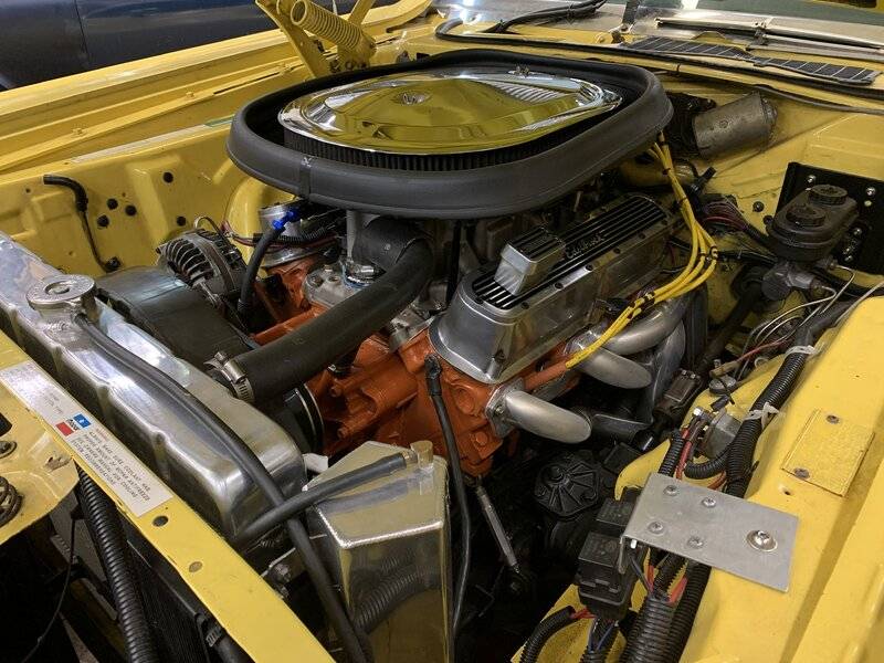

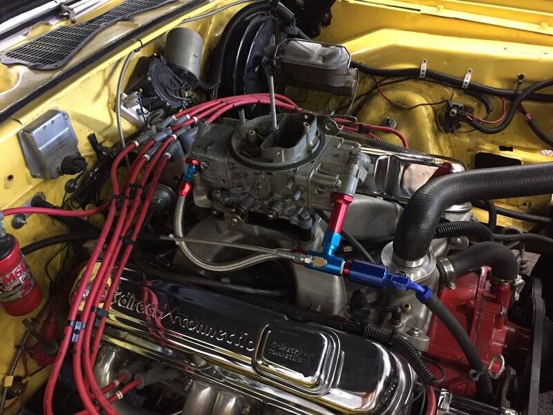

My 72's 340, .060 over, cast crank (I spit at forged!) neutral balanced, 70-down spec TRW forged Pistons fly cut to zero deck, Scat H-Beam rods, Ported Weiand Stealth intake, Ported Speed Master heads (before they we're cool) with 2.05/1.60 valves, and a probably too small for the Combo 703 VooDoo Hydro cam tied to a TKO 600 with Mcleod clutch and SFI flywheel.
The Cheesy PCV valve is replaced with a Wagner dual flow.

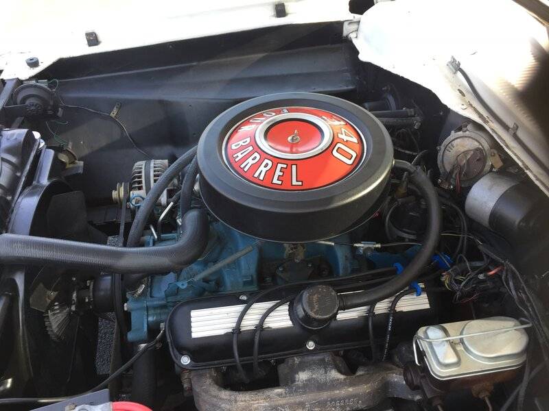

340 6 pac in my challenger
416 4 bbl in the same

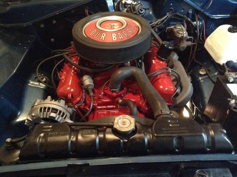

360 4bbl in my 67 barracuda conv.

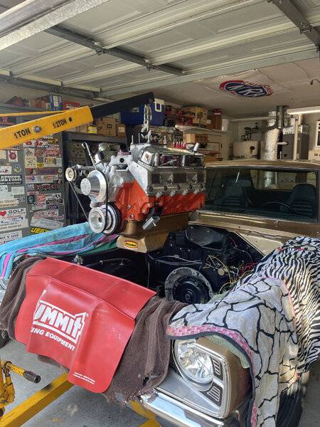

And the same 360 getting a make over

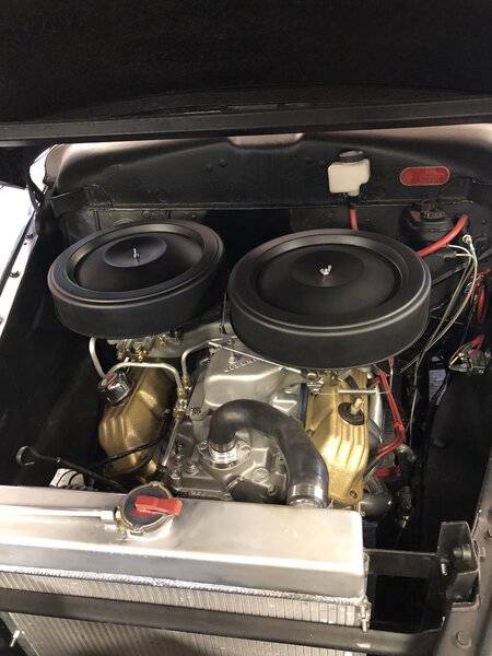

440”, R3 block, Indy heads, solid roller. Pump gas street car under construction.
