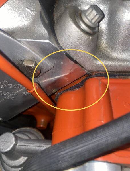

Hey guys, i swear lol if its not one thing its another and at the same time. I have always had a issue every once in awhile with the front pass intake bolt leaking ever so slightly, can hardly notice it and it doesnt do it all the time, i have resealed the bolt once with permatex #2 and it has been good for at least a few years but recently has started to weep a little. When i say a little i mean it might go for weeks before one little drop runs down from the bolt. Ill wipe it clean and then it wont weep again for a few more weeks or longer. But thats not my main concern. Last night while looking at the radiator i noticed the intake leaking ever so slightly, i wiped it clean and after about 8 hours theres one little trail and a droplet. I know the 100% right way would be to pull the intake and reseal it but is there any other option?
you can barely see the little trail and droplet

The leak is not in the threads so permatex wont help . Its the mating surface between the intake and head that is leaking . Do as TT5.9mag suggested and get engine hot and retorque all the intake bolts . Dont over tighten or you could strip the threads in the head . They only require 35 ft-lbs .

retorque the intake bolts on BOTH sides of the water passage, not just the one where you see water. It isn't the bolt that is leaking it's the water passage seal

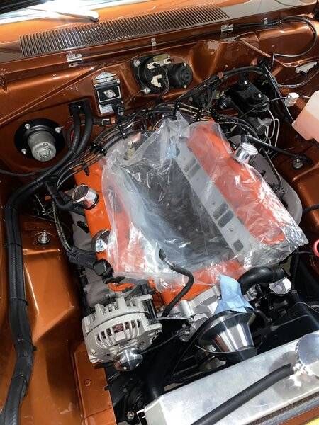

Bit the bullet and pulled the intake
gonna try to get the intake back on tomorrow night.

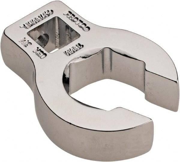

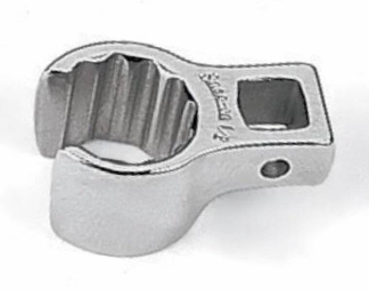

Also on the intake bolts some are hard to get to with anything other than a wrench, how are you supposed to torque them?
Make an educated guess.
