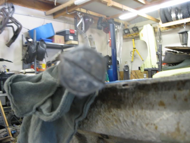

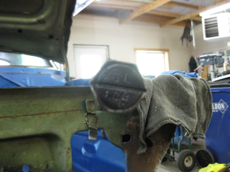

Problem is with both sets of bars they have numbers on both ends.my 69 had the part #s 890& 891 to the front the scamp had one in backwards.I asume by the condition of the rest of the frontend that it hadn't been touched.So which numbers go to the rear? Also the clock mark are different end to end ,clock from the rear?here is a pic of one bar
