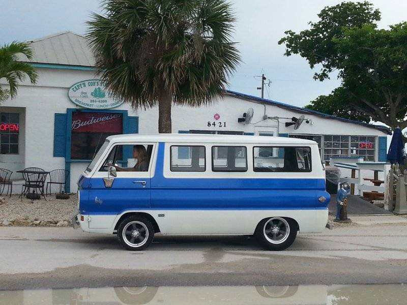

After a hundred miles or so on the Van with a 904 swapped in, I have noticed a chatter in it on pulling away from a stop. Once I get moving the chatter stops. It's almost like on a manual chatter when you let the clutch out . The dash and steering column rattle and shake a little bit. I swapped in a 904 that I had laying around in the garage for a couple years that worked fine in a little rat rod I had it in. The van has 2.94 rear gears. I used the stock mount from an A body ( rubber mount in the cross member) hanging from some steel angle to support the rear of trans, seems pretty solid. Just wondering if this is a sign of something in the trans slipping ? Band needs adjustment or clutches getting bad or what. Any TRANS GURU'S help out there would be appreciated
