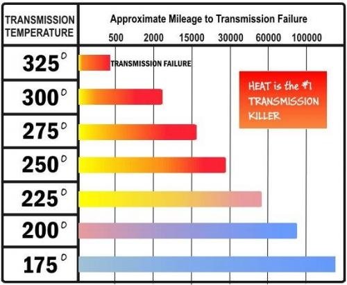

This chart tells you everything you need to know. If you use synthetic trans oil it will tolerate higher temps and last even longer.

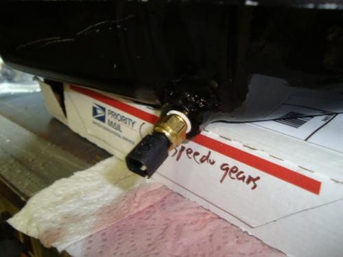

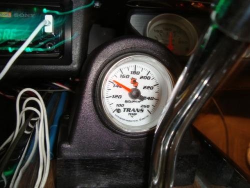

I used the pan sender from summit and it worked out great!! I was really surprised how long it takes for the tranny fluid to come up to a good running temperature. I also installed a good sized trans cooler and my fluid stays 180 or below.
