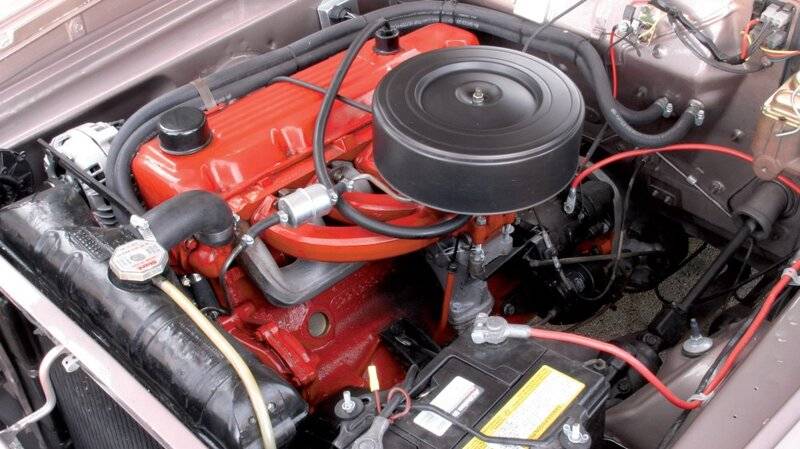

Got pics of your engine compartment? Not ideal, but how about twin small condensors with fans on each side behind the headlights?
It's a thought...not mine - but same as...you can see how tight it is....
