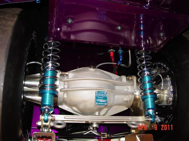

Here are some pics of the chassis. My goal is to build a street legal (or pretty close) race car. It will be insured and registered but no inspection sticker because no windshield wipers. All of the floor, front suspension, rear suspension, torsion bars, etc. were cut out of the car, to be replaced by this chassis we built. It is all chrome moly and built to sfi 25.4 specs. This means it is certified to run as quick as 7.50 seconds in the quarter mile. We missed getting a 25.2 spec (6.00 in the quarter) by one bar which would have gone under the footwell under the driver. We elected not to weld this bar in because it would have killed our plan to run an exhaust system on the car. Had to compromise and realistically have no plans of ever going that fast anyway. I had the complete chassis powdercoated before we lowered the body back on it. This car is all steel except for fiberglass hood, trunk, and bumpers. All glass is real (no lexan) and with me in it it weighs 2900 lbs. Strange struts are up front and AFCO shocks and a 4 link in the rear.

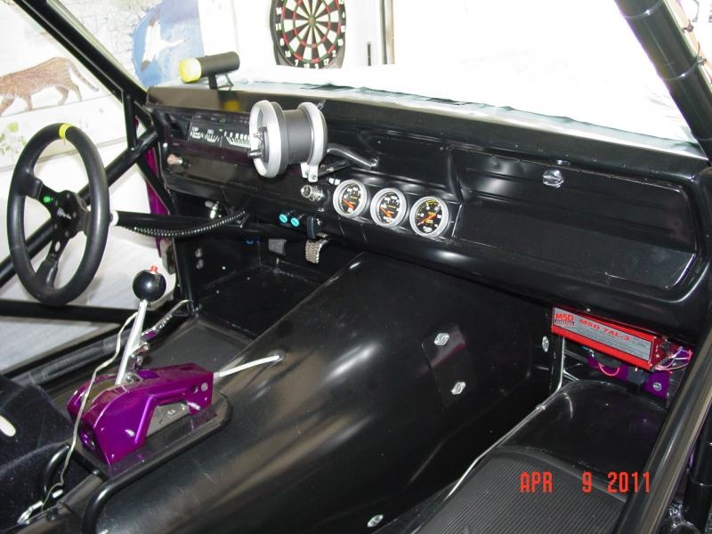

New photos! I am also showing some before and after for perspective. One thing I am especially proud of is the dash. Most cars built like this lose the dash and end up with some aftermarket or homemade piece of aluminum hogged out for some guages. I wanted as much street look to this build as I could accomplish. We took 6 inches out of the middle of the dash and used a silicon bronze rod to weld it back together so it could fit with the down bars of the cage. I think we pulled it off pretty well. Also, I had my Weld Magnum wheels sent back to Weld to be converted to beadlocks and they did a great job. Thanks for looking.

luv the dash.....always amazed at what a little slice and dice will do...I realize though what looks like a simple mod takes a ton of thought/work to make it seem that it's simple.....did I say that right???

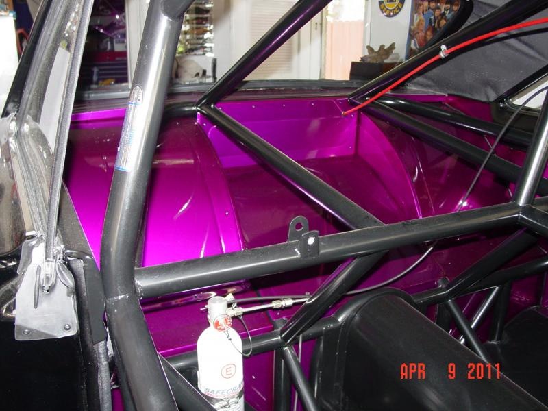

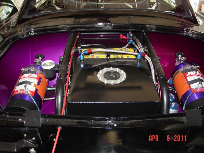

I've had some people ask about the wheel tubs and aluminum paneling in the trunk and back seat area. It is all powdercoated purple with a clear powdercoat on top. I used black 1/8" rivets I got from Speedway Motors to finish it all off.
Here is a pic of the aluminum panels I cut from 4x8 sheets. Each started out as a cardboard template and after cutting were beadrolled for strength and design. It took me about a month to completely fabricate the wheel tubs and panels. Since each is a one off piece I had to make sure my powdercoater guy was extremely careful not to drop or bend any. He did a perfect job and I'm lucky he did.
