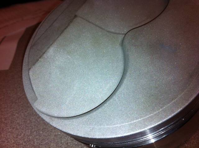

1973 400 block. Magged/sonic checked. It was Hardblocked to the bottom of the 'freeze plugs'. It had alloy caps, bushed lifter bores, 1960ish bobweight. 4.0" Crower crank, 2.1 journal 6.700" BME rods.
Wow at that bob weight, that's exceptional.
It was 1955grams with the dished 4.395 bore Diamond 518gram 990x.120wall 1.224C/H 6.700" BME '396' rod 2.100" journal Crower 4.0" crank.
It's now a 4.390 bore Ross piston which is coated oversized for the 4.395 bore. I had the dome removed and the tops milled down to the same c/h. With internal milling and installed a heavier .185 wall pin as requested by the new owner and a rebalance at 1985grams.
Started life as some odd type of odd dome with a ?quench bridge? that I didn't like...
Wow, that's a very strange piston.
Did you have line to line coat the pistons?

Not a machinist. I taught myself how to do things on equipment that's available to me sporadically. It just takes me a long time to do something a machinist can do in a fraction of time. Originally I took one piston and clamped it in the lathe with a sleeve around the skirt (verified run-out) and then I cut the dome off to help conceptualize some aspects of a theoretical build. There I learned they could be repurposed to what they are now and had Rebco do the rest because I couldn't beat their price, timing and quality. After, Line2line did coat the skirts.
