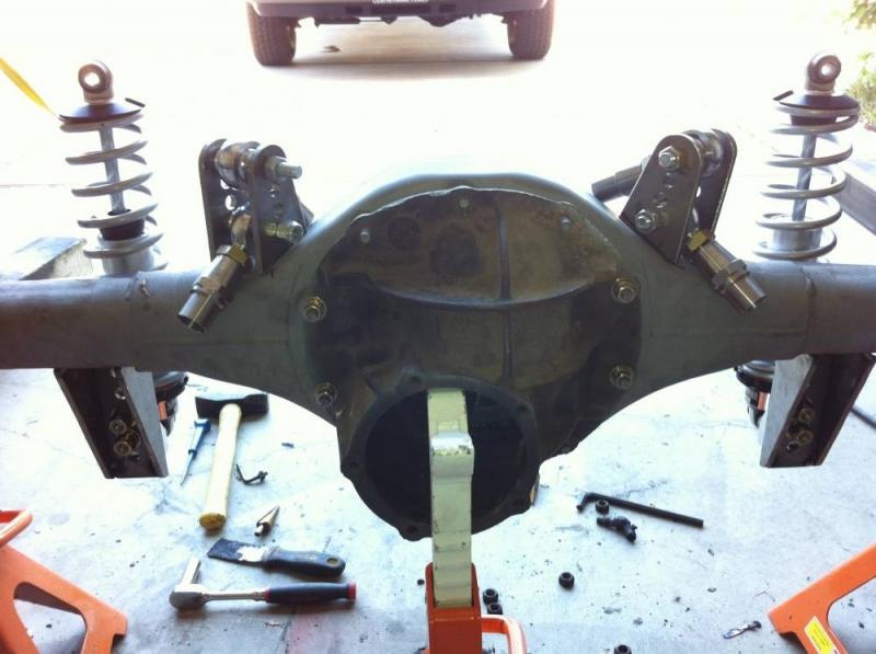

This is slow process when you need to make all these brackets. Sanding them in and drilling them takes quite a bit of time. It is getting there slowly.
The band saw motor took a dump. We got another one and need to change out the pulley. I still have the 4 lower link brackets to cut, sand and drill. Along with a few more pieces for under the car at the lower arm and the upper attachment Link Bar location. You can see the 4 plates I have with 5 adjustment holes in them. There are a few more pieces that go with that also.
There is still some room left for a wheelie bar attachment so I am thinking to go ahead and put those brackets on also before powder coat.
Yes I am only using all those heims for the correct spacing........
Looks real nice.. I love the way you put your shocks straight up... I didn't think there would be room on mine to do that or have a back brace.
I spent quite a bit of time laying on my creeper measureing everything so I hope all my calculations are correct. The shock tower will not be in the trunk from my measurements. At first I thought it would be but since the car will sit really low, I lowered the shocks down on the axle brackets to keep it all under the trunk.
Yeah we did the same with my car as well.. what length shock are you using? Also will urs sit about how mine sits? I can't get any lower without the rear tire hitting the back of the fender.. not to mention the shock right now is mid tavel. If we would have put mine in straight up then we would have needed to go with a shorter shock. my rear shock tower bar is located 1/2" from the bottom of the trunk hump.
