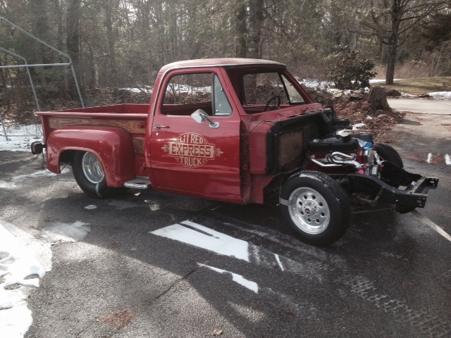

Nice truck! The op is on Ladder Bars I think it gunna hook! 2 - 90 lb bags of cement in the bed will help too! Lol
My truck is full back half with four link and coil overs. With fuel tank, batteries and little weight pockets in front of the rear bumper it should hook. I only plan on going to the track twice a year ( Mopar day and Truck day.) but once bitten by the bug who knows what will happen.

BTW, how did you lower the front? Did you change the suspension? My Ram had Chisholm drop lower control-arms and springs. Had a nice stance.
Oh, Thought it was ladder bars cause it is posted as such in your Post #1. 4 link and back half all the better!
I lowered the front with pocketed lower control arms and dodge Dakota spindles. Tubular upper control arms. I just checked my #1 post i'll have to edit that. Thanks for the catch.

Haven't updated in awhile just waiting on parts. And warmer weather would help. I'm trying to bring the front down 2 more inches but can't find shorter springs. Might have to go coil over. That mirror has been flopping around since I bought the truck 15 years ago and I just never fixed it.

Waiting for chassis shop to install cage. My slot is June 1st. Once that is done project should move fairly quick.
