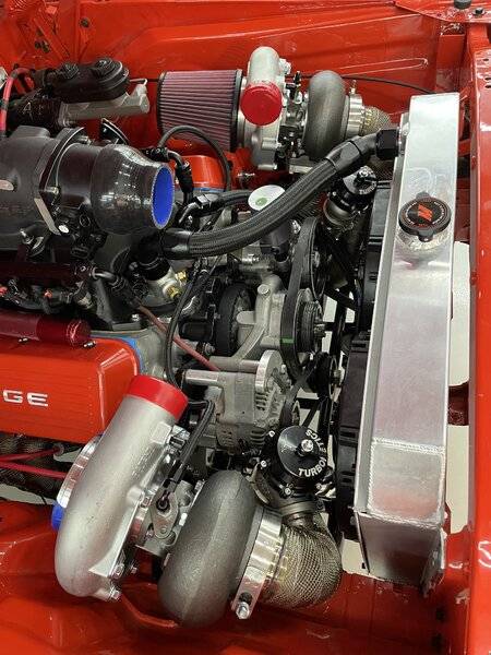

Got the Wastegates all mounted and wrapped. Now the oil drains are next.

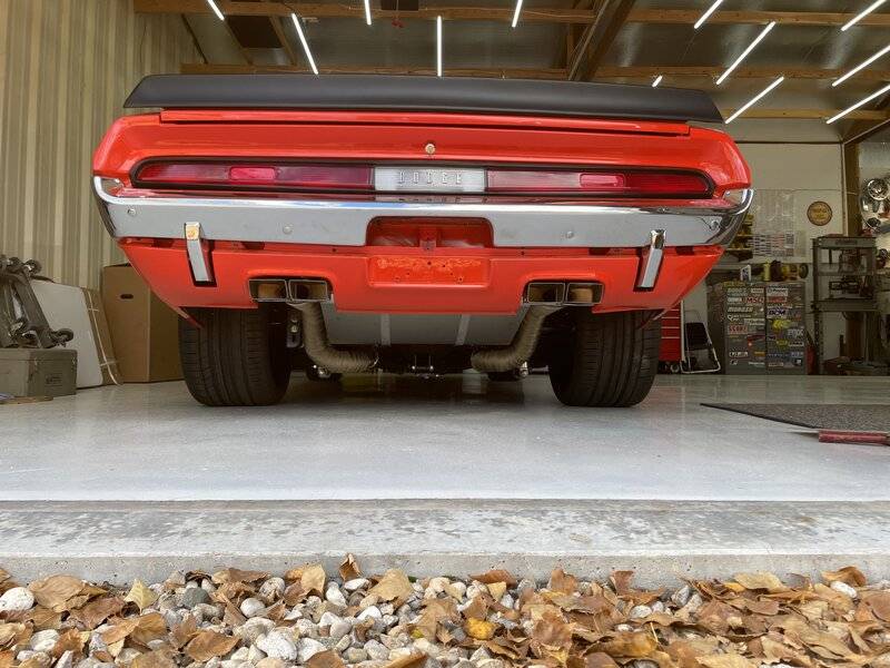

I finally got the car together and on the ground. It runs now and just need to start dialing in the efi. It’s just cold up here and snowing on and off now. This keeps me from doing too much.
Here is the engine compartment done except it now has a thermostat in the upper hose.
