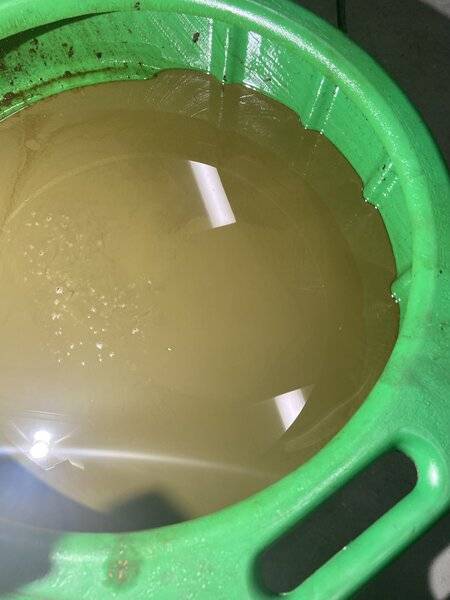

I was getting my Dart ready for its maiden voyage and decided to throw some fresh oil in it. The engine has less than 5 miles on it but it’s been sitting for a few years with start ups roughly every month. Oil never looked bad but I wanted to be safe. This is what I found. Smelled like fuel pretty bad but I wouldn’t think fuel or assembly lube would discolor it that bad. Running a pressure test on the system to check for leaks but part of me still hopes it’s something minor.
Pour some in a glass jar and let it set to see how it separates.

I know it had fuel in the oil from flooding it. Brand new fuel pump.
Condensate in the oil.... Only driven five miles and never run long enough to eliminate condensate... Short runs every month are worse than not starting the engine, either run it for 30+ minutes to build heat in the engine or don't start it...

I have never seen condensation change the color like that but that is what my old man said. If it passes the pressure test then I’m going to let it run for 30 minutes in the garage then check the oil again.
its either water or anti freeze, either will do the "chocolate milk" thing to the oil, it wipes bearings also.
anti freeze gets in from a few places, but a common is the intake gasket leaks into the lifter valley, I use silicone around the water ports of the head/intake for many years now because i had this situation happen once. you could pressure test the system, oil drain plug out see if antifreeze comes out the oil pan...

No brass in the filter and oil pressure is still holding at 60 so I don’t think it has done serious damage to the bearings yet.

Put a match to a small quantity and see if it ignites quicker than just plain oil. That will tell you if it’s water or gas.

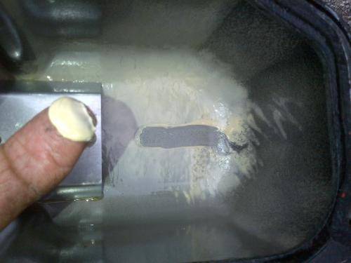

If you pull the valve cover, you may find some foam in the cover .

Fuel does not turn the oil milky like that. That is water either coolant leak or condensation. Is the coolant full still?

I have not lost a noticeable amount of coolant. That paired with the fact that I have zero smoke coming out of the exhaust and zero leaks is what has me slightly hopeful. If this would have happened before I was married I would be looking for every excuse to pull this motor out and build a stroker but of course this happens when funds are low.
