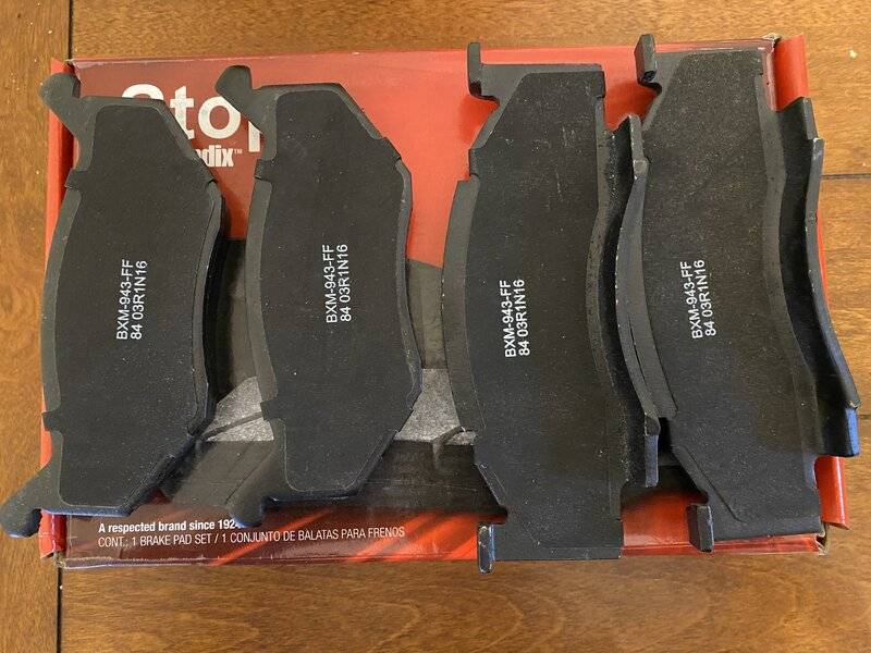

Got my first batch of parts in. Usa made timken bearings, not too thrilled that the timken seals are made in taiwan but i guess better than china. Got the bendix pads as well, they are listed on summit as riveted but these are bonded which im happy about, ive never seen a brake pad with a burnishing compound on it though.
According to bendix the blue stripe is a titanium burnishing compound that eliminates the need to bed in the pads.

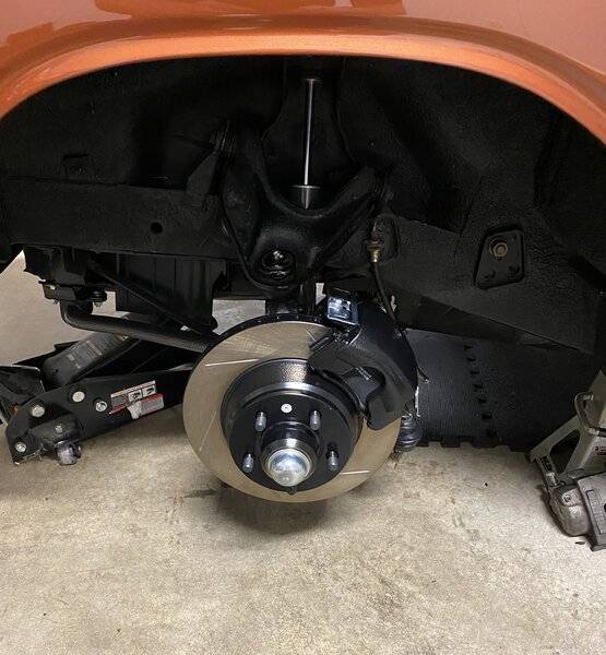

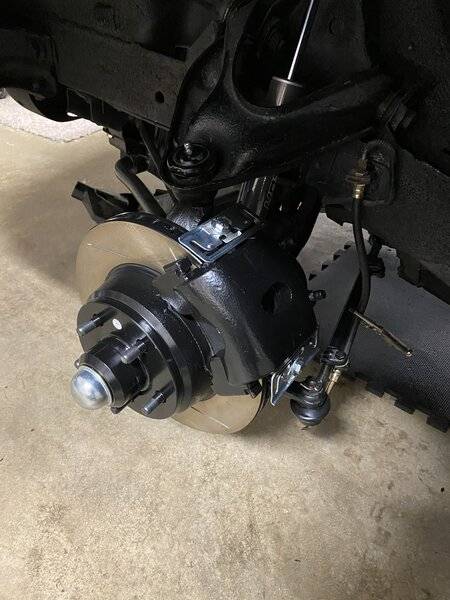

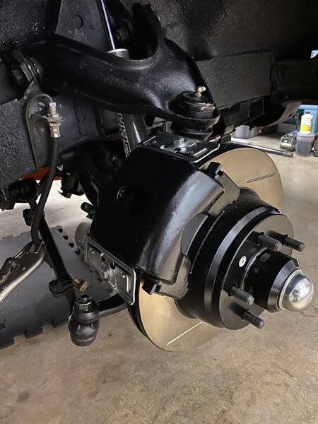

yesterday got the 11” ssbc rotors off along with the caliper brackets and brake dust shields.
Tonight i removed the races that came in the new 11.75” stop tech slotted rotors. Installed the races for the timken bearings, cleaned, painted and reinstalled the dust shields, packed the timken bearings with lucas xtra heavy duty grease. Installed the new slotted rotors. Installed new 11.75” rotor caliper brackets along with new 2.75” piston calipers that i bought from dr diff. I love how the calipers have 2 bleeders so you can mount the caliper in any position. Just lack installing the stainless braided brake hoses.
