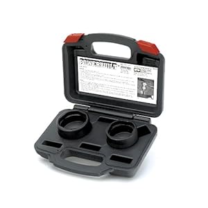

do you need to but a upper ball joint removal tool in order to remove them or will any old wrench work?
[ame="http://www.amazon.com/Alltrade-648749-Specialty-Joint-Socket/dp/B0028QGT8Q"]Amazon.com: Alltrade 648749 Kit 32 Specialty Ball Joint Socket Tool Set: Home Improvement@@AMEPARAM@@http://ecx.images-amazon.com/images/I/41XTQDKYQwL.@@AMEPARAM@@41XTQDKYQwL[/ame]
lol amazon has just about everything...lol these look like them

Does that Amazon kit actually have the smaller A Body upper joint socket? There are three sizes, and a lot of the time, the kits don't have the smaller one that a lot of the A Body guys need.
