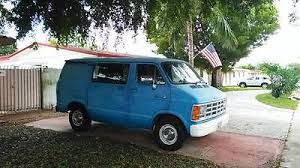

So I am thinking of buying a 92 dodge ram shorty van that has a dead 3.9 v6. The van is VERY clean as far as the body, with NO rust.
The interior is faded and old but very solid and complete.
Would it be better to pull the 3.9 and see what's wrong with it OR v8 swap with a 318
Any foreseeable advantages or disadvantages
The 3.9's actually pulled those quite well. I mean, not a race vehicle but it won't be if you put a 5.2 in it either. If you just want to drive it, the 3.9 will do just fine and you won't have to mess with any wiring/computer for the FI system. Just my thought...
That looks like a Conversion Van, as in finished off inside with "plushness." We had a Chivvy G20 back in the 90's and they are pretty heavy. That had a 350 and don't think a V6 would have made me happy, LOL. I don't know how much different fuel mileage would be from V6 to 318. If it is not a conversion, then ignore my rambling.
Put a 440 in it. That doesn't look like a shorty.

Does this help any to know what it is ?
OH YEAH! Sunhawk Products is who did the Conversion. It's classified as a custom coach van. I imagine it's automatic transmission equipped. That's a whole lotta vehicle to pull around the mountains of Colorado, but the 3.9 has decent low end torque. I would say magnum V6 swap while using the existing LA engine TBI and distributor with the kegger intake. The other deal would be figuring out if the EGR control would work with the externally connected magnum EGR setup, but it should be fairly adaptable, too.
That means it was sent out to an aftermarket company and it was modified. Like with that big whopper john window on the passenger's side. That's not factory. Get us a good shot from the side. I don't believe that's a shorty van.

I’m actually partial to 318, too. It’s probable that it could get better fuel mileage in that heavy vehicle if you are going up or downhill all the time. As far as it being worthless as a conversion van, that depends on what you intend on doing with it. You can gut it out and make a standard utility van out of it, but just with extra glass in it. I went to a bike rally (Boozy Creek) for a weekend years ago in a dodge conversion van much like that one. Good Times!
"Shorties" have no panel between the front door and the side door.
I believe that's what we see in the pic.

Ok maybe it's not a shorty ...I don't know vans very well and the seller mentioned shorty but I don't know.

But look at the rear overhang. Isn't it a bit much, or is that my imagination? It just doesn't look like a shorty to me. Maybe it's the camera angle.

There are actually many different lengths. Yours isn't the longest by a long shot, but not the shortest. Here's a shorty. See the difference? It's still a cool van though. Worth doing something to......cept for maybe the gas mileage. Even with a V6 it'll suck. lol
