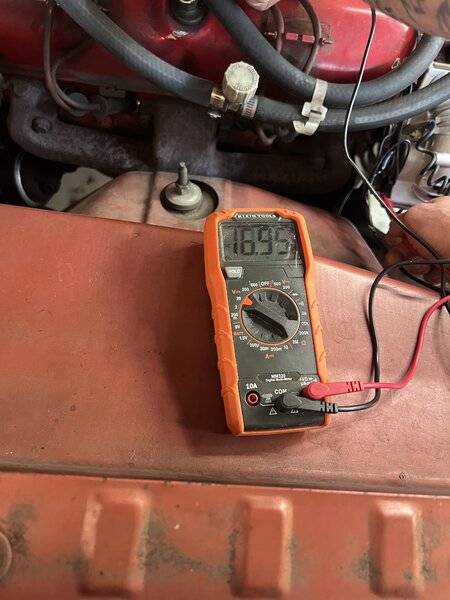

Did you check the voltage when it makes the whirring sound?
That usually means it’s putting out a lot of voltage.
The current problem sounds like the regulator is garbage.

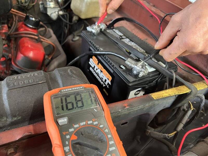

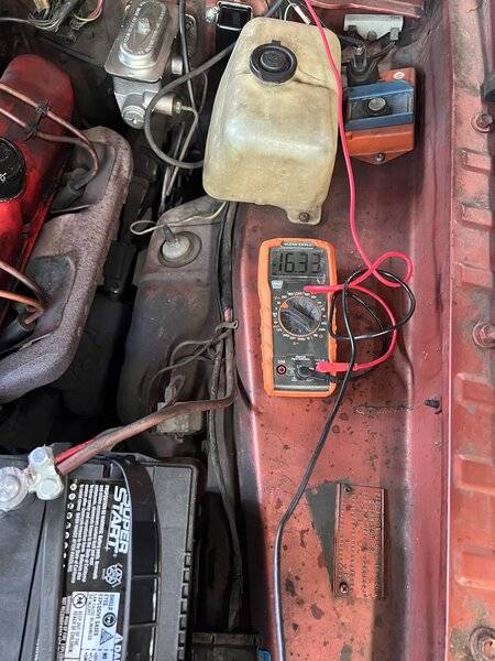

Can you determine if it is charging, or not, and when? Can you rig, even temporarily, a voltmeter so you can monitor system running/ charging voltage?
First thing I would do is make sure the battery is charged, (on a charger if necessary) and take it somewhere to be load tested. You want a real carbon pile load tester, not some toy someone carries in their shirt pocket
Then if you can determine the battery is in good condition, you can move on the the charging system.
If you are unaware, the factory ammeter show show charge ( to the right) after starting engine, and should "taper back", generally to center and hover pretty much at center after getting the batt up to normal
A voltmeter, if you can rig one, should run about 14V when driving off idle.

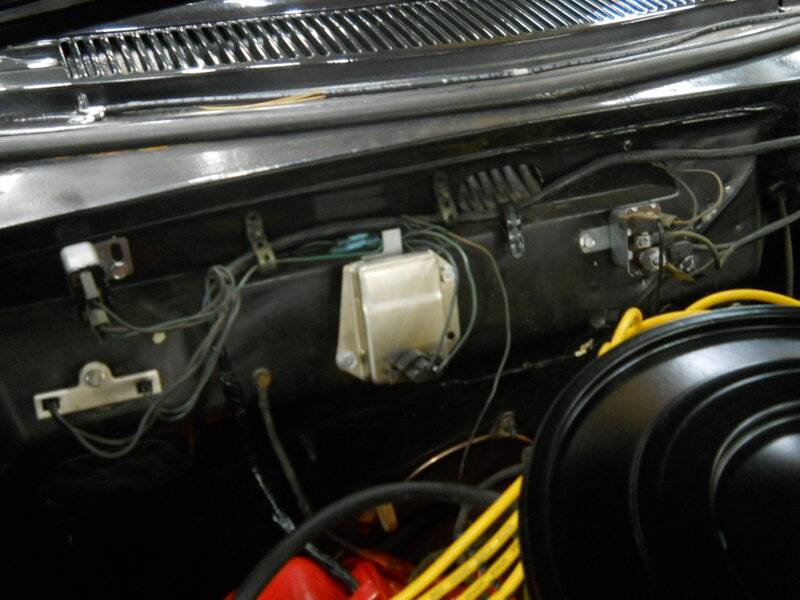

When the electro-mechanical sticks in the on position, it triggers the alternator to full-power, full-time.
Obviously, if it does this, it is well grounded.
With the alternator running WFO, guess how long the batter lasts.
Get rid of that old-style regulator.
BTW, I have seen my Mopar "constant voltage" electronic regulator stick "on" as well, and the result was over 20 volts output into my Optima battery. I caught it almost right away, so no damage was done. Still, it was a scary thought for a second as I was a couple of hours from home.
