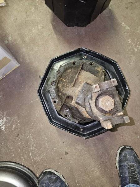

I have the round stand up style and the rectangle horizontal style at the shop. I use them for 9". I am currently out of the shop until Thrusday, but I happen to have a few empty cases and 3 mopar chunks. So if you would like I will test fit/photo in both style cases and let you know what I find.

Ok...the round style I have has no name on it. I don't like the fit. Almost looks like I would want a metal ring to keep it from falling through. Also, the yoke hits top and would have to be removed to completely close the case. It seemed a little "tippy" and will likely roll on its side when being handled by a shipper.
The box style appears to be the way to go. The one I have is a Moser brand. It is a tight fit, with the gear and the yoke both touching the ends, but it was not a squeeze to get it in. Top fits properly.
I wonder if this one would work? Although, I suspect it may also be too short for an 8.75 with the yoke. I like the vertical style better since I don’t plan on moving it around much.
I am afraid that one is also for the Ford 9", and if you look at my photos, you will see the 8-3/4 comes close to falling through the hole in the 9" round case. I find the rectangle box is also much easier to hold and carry.
