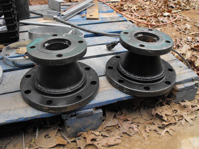

Example of my 5/32 5-P+ pipe welding on a job site.
Wow! As a (hopefully) soon to be retired Pipefitter (Service Fitter, Local 539), let me say this: Nice work!

Can I weld as good as the example in your picture? Oh, hell no! But I can weld, and I like to think I can spot good work, and would be proud if I had that same level of skill.

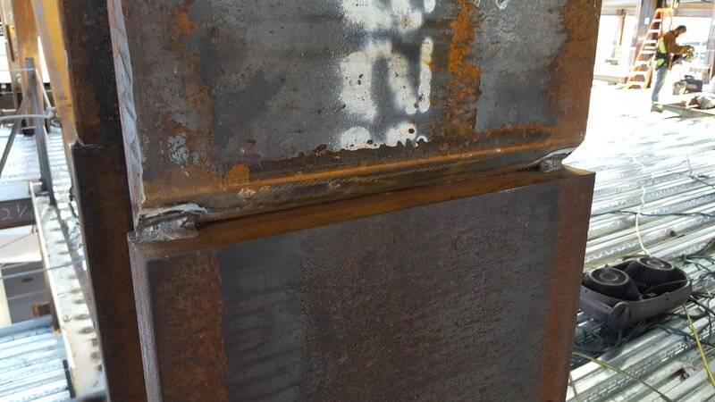

Pics of when I worked out in the field... Before and after of a column splice. I used mig welder with flux core wire.... no gas shielding. This is what they call "partial penetration"
