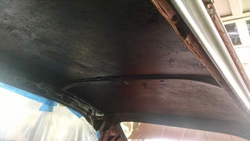

before
attachment.php
after
attachment.php
