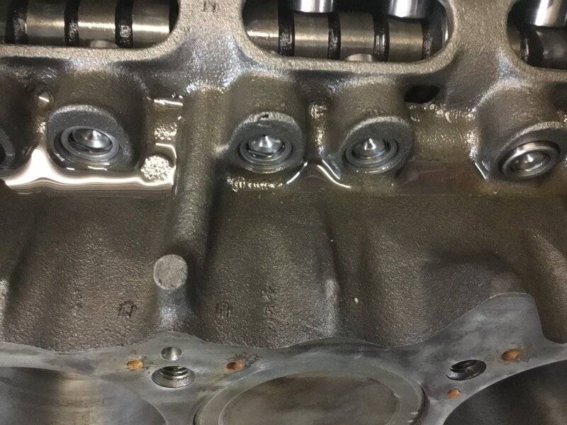

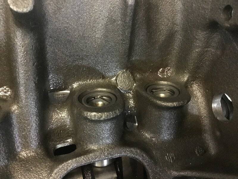

1st pic is #6 lifters. 2nd pic is #1 lifters. The lifters are too far down to put a straight edge across so i measured from the top of the lifter to the top of the lifter bore. .07, .06, .06, and .06 were the measurement. does this look right?
Yes it “looks” right. Is it? You won’t know for sure until you put a degree wheel on it. All you can say for sure right now is it’s close.
Post #129,
When the lifters are below the lifter bores, piggy back another lifter on top to get an accurate measurement. Take note of where the two lifters come from so that they can be returned to their correct bores.

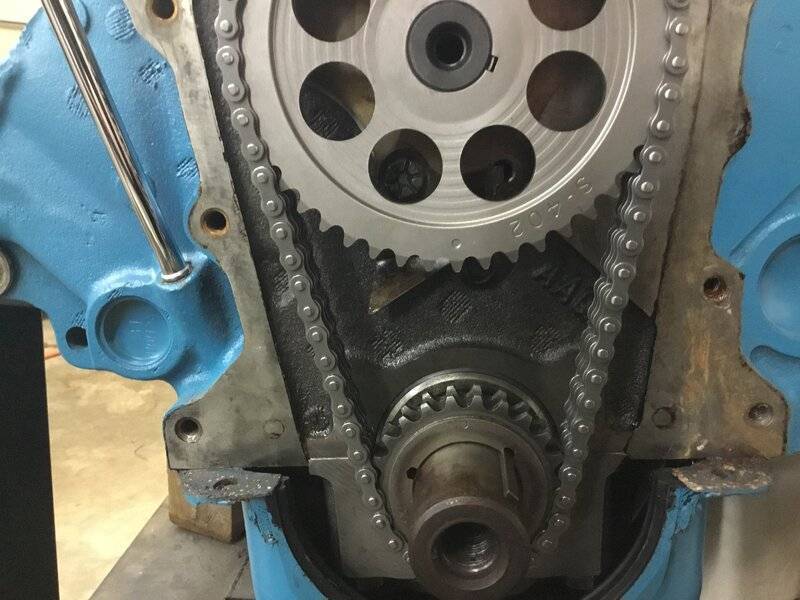

I’m not sure which combination of marks will end up with the cam retarded a “bunch”.
The typical screw up is the crank key straight up, lined up with the dot on the upper gear pointing straight down.
This makes the cam 2 1/2 teeth(about 35*) advanced.
I've seen this exact scenario in person three times... Guys who have built lots of GM & Ford engines expect the keyway to be straight up... Their general knowledge is fine but when you assume something it usually bites you on the ***...
