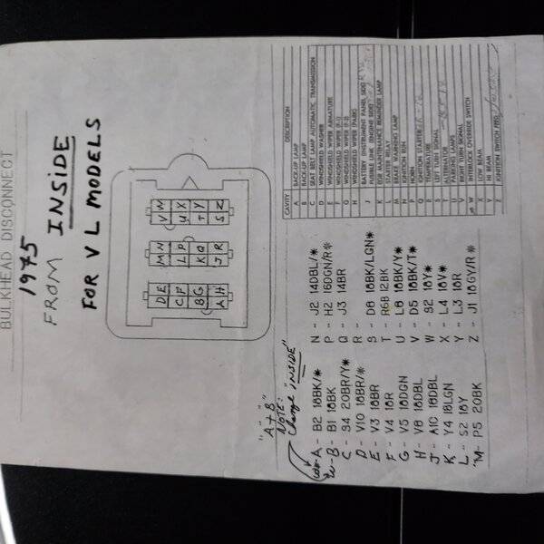

Use these copies for color codes and locations at the firewall connector. They are from a 75 Swinger's factory manual.
If you can locate wiring harnesses out of 73 to 76 "A" bodies . Be sure to check cracks and splices and clean every connector.
Splice with SAME colors.
Good luck
