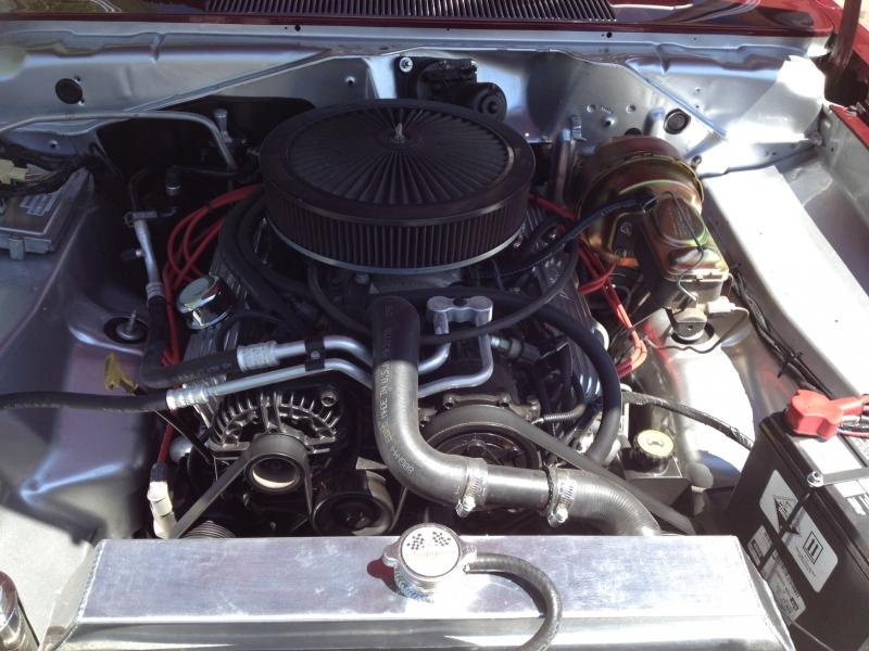

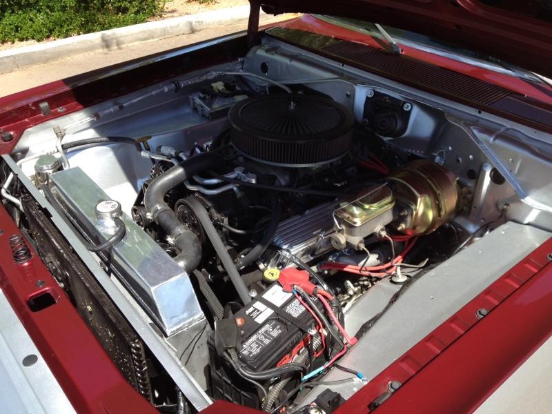

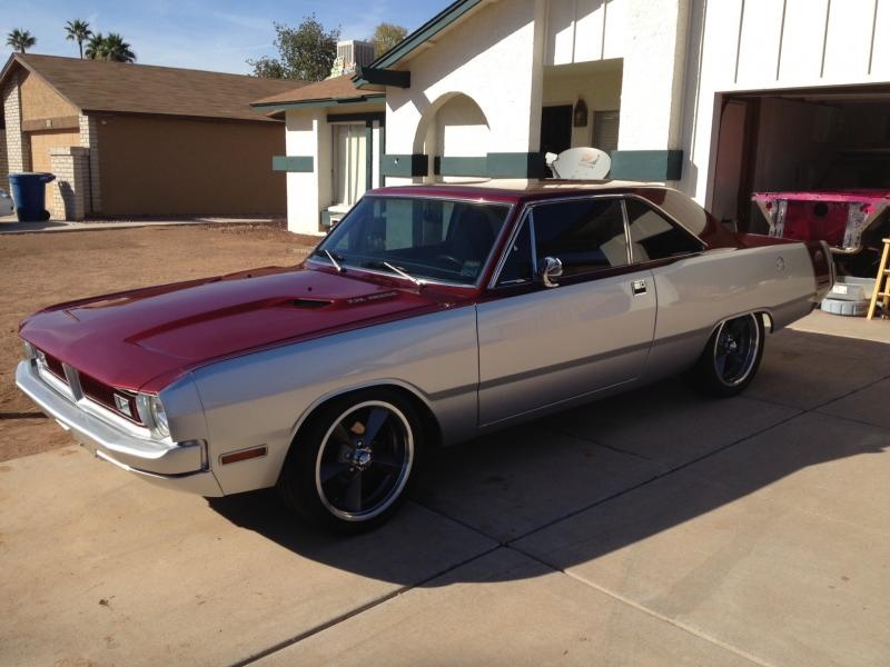

Sorry for the long delay in updating the thread. Here are a few pictures of the car. I changed out the wheels a few weeks back. Let me know what you guys think.
Beautiful...just beautiful. It all appears like it could be factory installed components. This car is motivation for all who see it. Great job. :prayer:
Looks great. Have fun driving the wheels off of it.
Looks great! Really like how it came together.
i love the looks of those wheels and tires on the car!! are those streeters? what's the wheel/tire size and manufacturer?
higgs
super nice build, i wouldent change a thing, i especially love the smooth challenger door handles, and challenger styled hood. looks like the engine install is factory installed.
