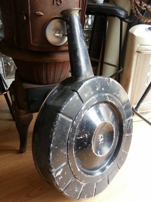

Next the breather top, all this came from the same garage with a 67 GTX .. I don't know if they was related :glasses7: Thank you all for your time again :D
Early Hemi or 440 car's ?

Well, I have been doing some looking and so far it douse look to be a 67ish big block breather.

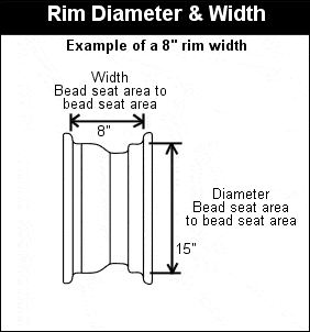

This is how wheel width, and diameter, are measured.

Pretty sure the widest 14" wheel they used was a 6" wheel.
Refer to the previous post on how to properly measure the wheel.

Read the chart above. That's how to measure them correctly, not from lip to lip.

This pair of wheels do measure 7 " inside lip to inside lip and are 14" even stamped 14"....
