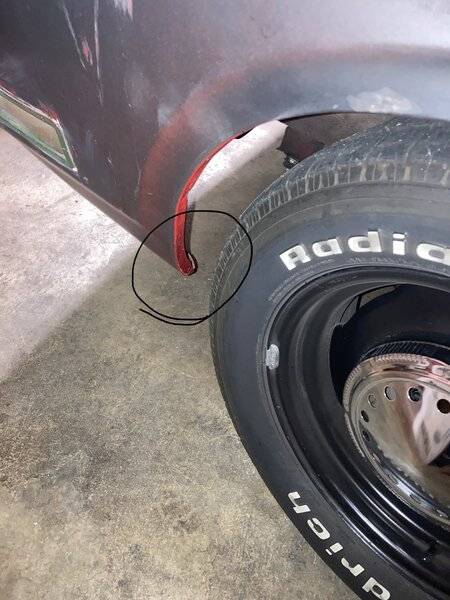

I have 215/60/15 on front with 15x6. If you run 235s you maybe ok, you may fold your fender over in a turn I’m not 100% sure . Maybe there are some guys on here that run them that will chime in. Below is a photo where it can hit. I do know a 225/50/17 will hit and according to this tire calculator, 235/60 is larger in size.
Here is picture Of the 17”. They were deleted quickly but it could have been a backspacing problem more than tire size problem. But what I’m getting at is if you run the 235s when you set the car down carefully turn the wheels with someone watching and make sure you have comfortable distance
Thanks for the images. Once I get the tires I’ll run those tests to make sure I have enough clearance in the front.

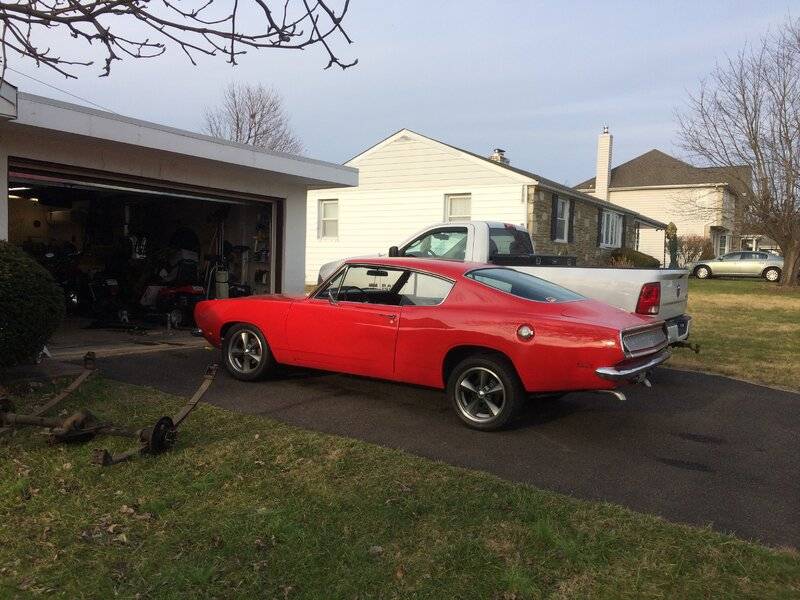

He has a 15x6 I think. We just switched to SBP Centerlines. I will tag him here @Just Ron hopefully he sees this and replies with front tire size. Here is the car. I guess it is 215/70R15
Ok so the tire is a little taller but not as wide. At this point I’m going to have to mount it to find out.
