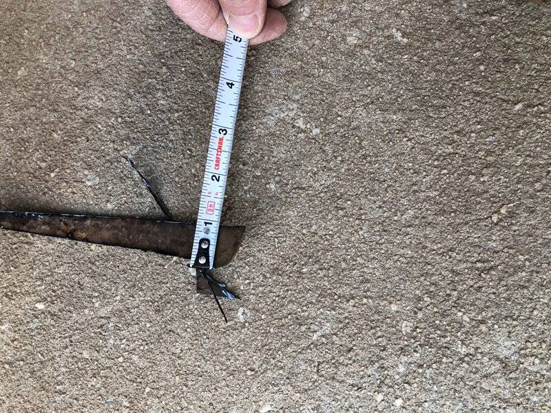

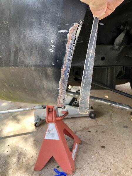

You can always mod the fenders if it’s not a show car
If I had known I was going to run into this situation I probably would’ve trimmed it the way you did. At this point, it’s not an option. My cars painted and this is practically the last of what’s needed. I wouldn’t mind snipping the inside lip corner if I need to but a modification like yours I won’t do.

I have 215/60/15 on front with 15x6. If you run 235s you maybe ok, you may fold your fender over in a turn I’m not 100% sure . Maybe there are some guys on here that run them that will chime in. Below is a photo where it can hit. I do know a 225/50/17 will hit and according to this tire calculator, 235/60 is larger in size.

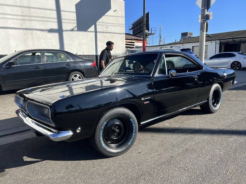

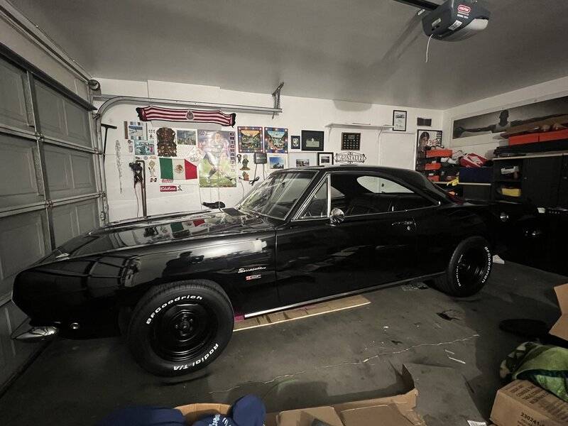

And here are pictures of it now.
255/60R15 & 225/60R15

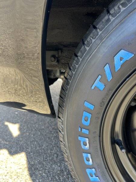

The 225’s fit but are tight, as you guys said they’re close when being turned but not hitting. It may be an alignment issue, I’ll have more answers soon. But they do clear. Images attached.
Flip the tires around, so the lettering is on the inside. I think the "all black" looks cooler.
I see what you mean. Well we’re on opposing sides on his aesthetic opinion bc I feel the white letters look pretty cool although I do like the all black look too
