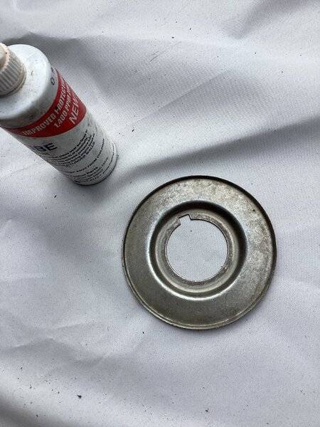

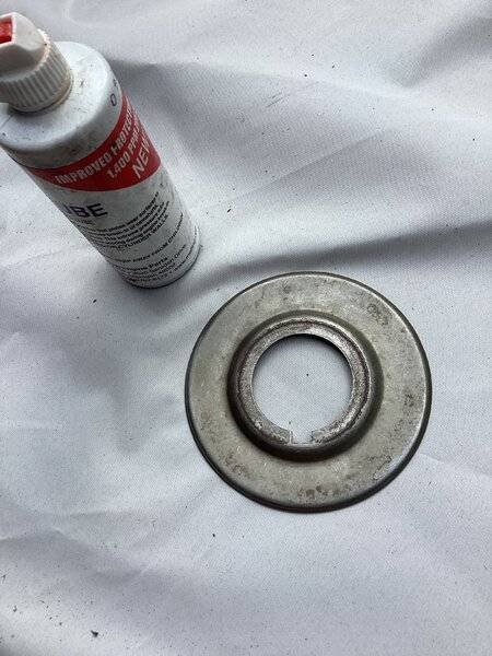

Putting a Dodge 318 back together. Where does this go?
Roger that!Agree with the other posts, but don't put it on backwards. The side with the lip (Your first photo) faces outward, away from the engine.
No, timing cover not installed yet. I was thinking that was where this went but it got separated from the cover when I was cleaning and wasn’t sure.If the timing cover hasn’t been installed yet, it goes on as described above.
If the timing cover is already “fully installed”, it goes in the “extra parts” box on the shelf.![]()
