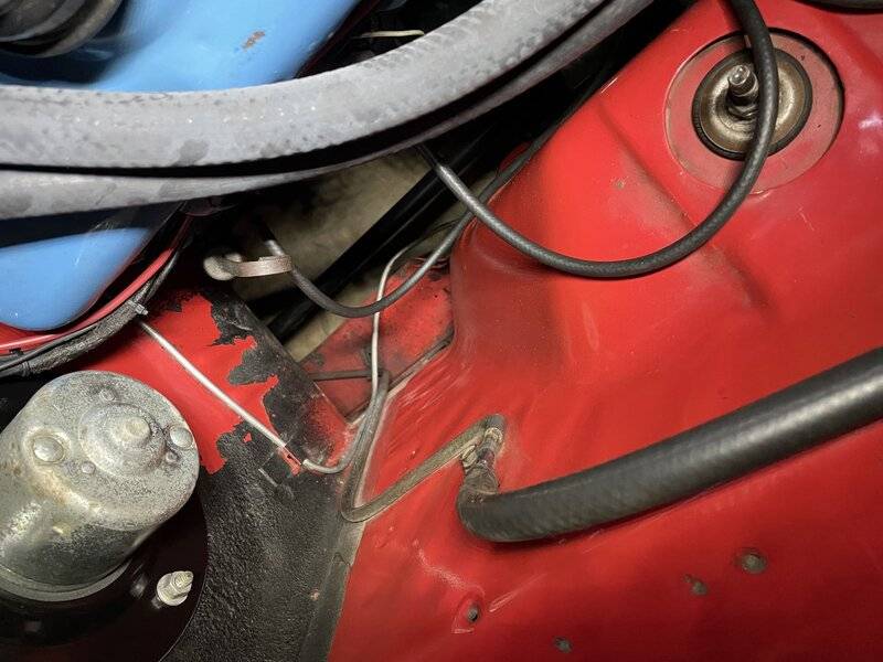

I have a 1972 Plymouth Duster and am trying to replace the vapor return line. Mine is 2 piece, 5/16" OD and all pre-bent manufacturers seem to say the line should be 1/4". I see listing of 5/16" for 1971 and wondering if that is the line my car has for some reason. For mine the line routes with the fuel line and terminates in the engine bay close to the firewall with the end being vertical. From there the rubber hose goes to the charcoal canister. Can anyone help verify:
1) Where the pre-bent 1/4" lines available terminate in the ending bay?
2) Where a 1971 5/16" vapor line terminates within the engine bay?
I have attached a photo of mine looking down from the passenger fender to show how it terminates. Also note that from what I can tell there is some kind of check valve in the front fuel line as it rattles when you shake it.
Worst case I can get a roll and try to bend my own but was hoping to be able to get a pre-bent line but I would prefer it to terminate in the same location and use the same attachment points.
Summit probably carries it.
The vapor line must come up high in the bay, and it has an anti siphon/ check valve at the engine end to prevent the tank from siphoning on overfill or if parked steeply downhill. Download yourself a service manual from MyMopar.com and get into the emissions and fuel sections of thebook
Also we have a lot of guys trying to insist on using them for a vapor return. That line is the VENT and if you use it for a return, you must do something else to keep the tank vented. The caps--NONE of them, are vented. The evap tanks have what is called pressure/ vacuum caps, which vent only for pressure or vacuum release, like relief valves. They themselves are a nightmare as they have changed pretty much every year.
