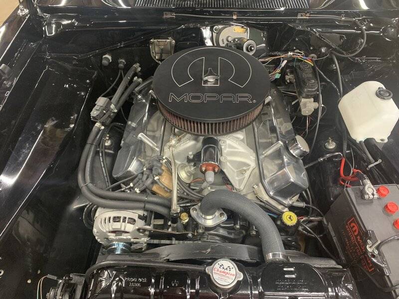

Here's a picture of my 505" in a 1968 Dart 270. Previous owner did all the work so I don't know how hard it was but looking at everything it looks like it wasn't too bad. Everything is pretty tight but I think I can manage. Headers fit but are real close. Hope they never have to come off. LOL.
