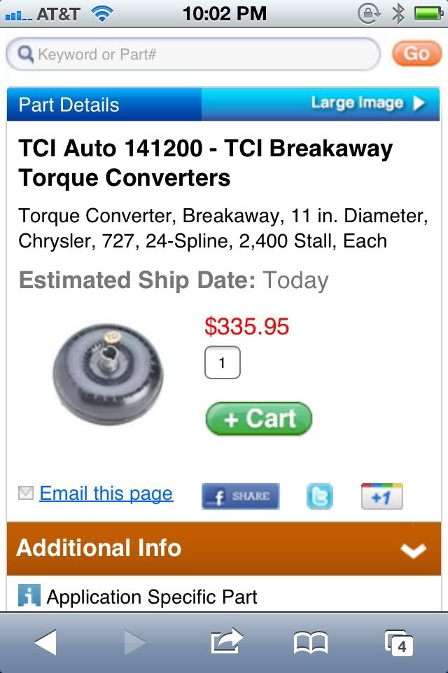

Thanks for the replys guys. Well the car is a 73 Plymouth duster 360 with a/c. The cam is a comp cam 280/ 480 around there. Since the car has been parked on an off for about 15 years I think it's time to get The trans freshed up and re sealed to get rid of the leaks. While there a fresh new torque converter with a lower stall would be great and maybe even get rid of that vibration I have while at 65 to 70 mph. this was the converter I was looking at.
IMO that's not quite enough stall for that cam. That cam needs at least 2500 stall and will perform much better with something along the line of 2800 stall. And don't buy an off the shelf converter. Their stall rating is generic and it may stall several hundred less or may even stall more than it's rating. You have to remember, what a converter stalls is directly proportionate to the torque an engine produces. In other words the same converter that stalls 2000 rpm behind a stock 360 may stall 3000 rpm behind a 440. You can buy a custom built converter for the same money, or less, from John Cope at Cope racing transmissions and it will stall what it is supposed to. As for the vibration, make sure you get a converter with the external balance weight for a 360 or even better yet upgrade your flexplate to a B&M unit that does the balancing so the converter doesn't need balanced.
