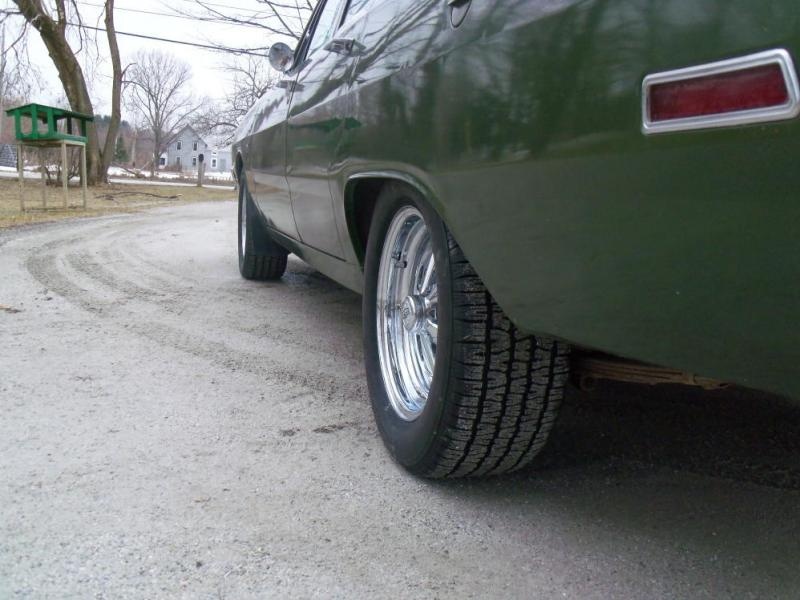

One thing is that when I swapped from sbp to bbp, I converted to 11 x 2" brakes from 10 x 1.75 which required the axles to be a tad longer for the larger brakes/drums. This set the tire perfectly centered between the lip n spring.
Sorry, just the rears, but these are 245/60/15's, bout a little over a finger clearance to the spring n wheel lip.
Looks good,and fills the wheel wells out nice.

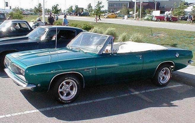

i have 245 60 15 on my 64 barracuda, on stock steel 15 x7. if you can find some wheels with more back spacing and bring your tires just to the springs you can cram some pretty decent tires under there.
good stuff!

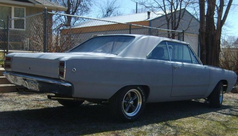

Stock 1970 Dart 318 Auto 8-3/4 Rear
BF-Goodrich Radial TA's
Front- 15x6 Cragar/SS 215/60/15
Rear- 15x7 Cragar/SS 225/60/15

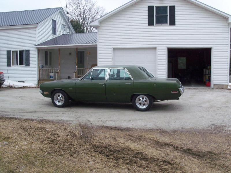

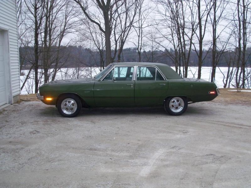

Ended up going 235/60-15 all around on stock 15" x 7" steel wheels.

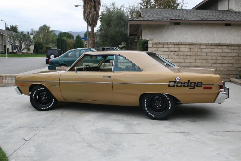

Finally got my bbp conversion finished and got my 15's on.
Fronts are 15x6 with 205/60/15
Rears are 15x7 with 225/60/15
