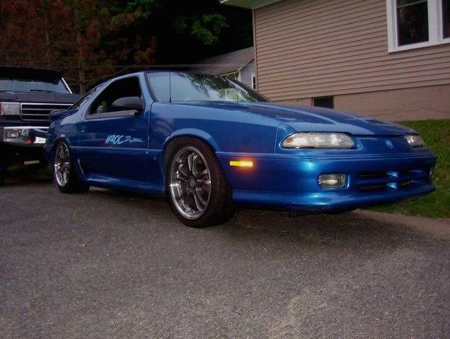

I run 18's on my Iroc Daytona,but not on my A-body.

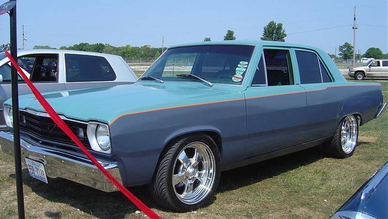

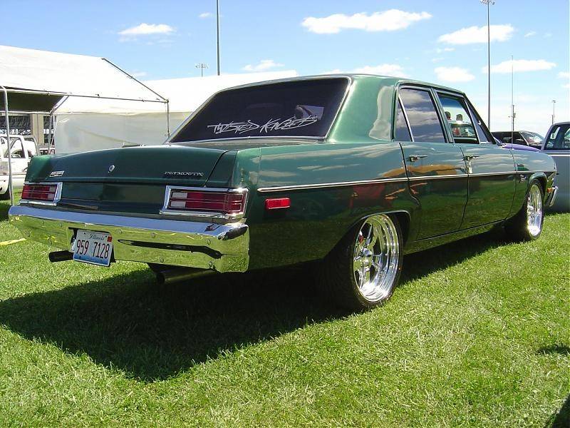

I have Centerline Retro 17x7 and 18x8's on my '74 Valiant. It's shaved in 2-tone sealer now. But it has a 408 stroker instead of paint! I like the Centerlines, because they offer custom offsets for their 2-piece wheels. Just measure and call, they will build to order.
Twistedvaliant -- Those look pretty good. I was looking at the same wheels from Centerline. What was the backspacing on each and which tires (brand of tire and size) are you running? It looks like you have discs up front. Which setup - standard '73-'76 single-piston factory setup?
I have been looking for some lighter wheels in the larger sizes and with the ability to have larger positive offset for the front of my 65. I have swapped in the '73-'76 single piston factory discs and was surprised by the approximately 2.7" increase in front track. I want to tuck them back in and still have the rear with normal backspace to fit the smallish wheel wells on the 65.
Yes, the brakes are stock, it's a 74, want to go to big 4-wheel disks, but first things first. As for wheel backspace, the front are 17 x 7 with a 4" backspace, and the back are 18 x 8 with a 4 1/2" backspace. The tires are Falken FK-452, 225-45ZR17 on the front, 245-40ZR18 on the back. They tuck very nicely.
I think that you can convert from the OEM drums to disks, several manufacturers make kits, but you would have to measure after installation to verify fitment. I used the wheelrite tool to check offset before ordering your wheels. If you are going to order these from Centerline, buy them direct, and look at all of the 2-piece designs, they sold me these for the same price as the cheapest 2-piece on the website, even though these are the most expensive of the style.
You can PM me if you have more questions about the car, wheels, tires, or any other questions you may have.

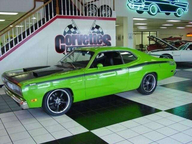

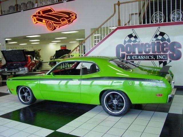

I dont know whos Duster it is, but I came across this one with 18's for sale on the net for almost $30,000...... but its nice!!!

I do agree w/ ya on the chrome, in most cases. Just another pic of a Demon on 18's and airride, in case your nausea had subsided.....lol
Butch
