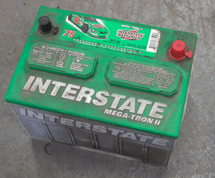

I just made the swap to agm, i got a Interstate MTX 34 Agm battery through work, about $175 my cost. Replaced a 2 year old mopar battery that is still good but will keep for a spare.
When I mentioned MT was Interstate's premium line I was referring to regular wet cells.
If 36 month is the pro-rate, that's not very impressive. If its a free for 26 months and then a pro rate beyond, that's decent.
36 free replacement, most batteries do not offer a pro rate anymore. Mopar and motorcraft are free replacement only. As with some other brands
