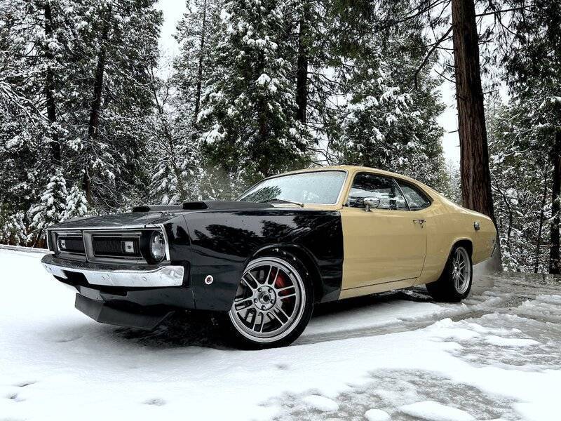

I ran 225/60/15's on all 4 corners of my Duster for awhile with cop wheels, 15x7 with a 4.25" backspace. Now staggered with 275/35/18's on 18x9's in the front with 295/40/18's in the back on 18x10's.
img_9945-jpeg-jpg-jpg.1716192727
How much trimming of the finders did you do? And what back spacing? The prior owner put 16’s on my car, which the selection is nothing.
Testing out the front tires on the rear, they look a little small back there :lol:

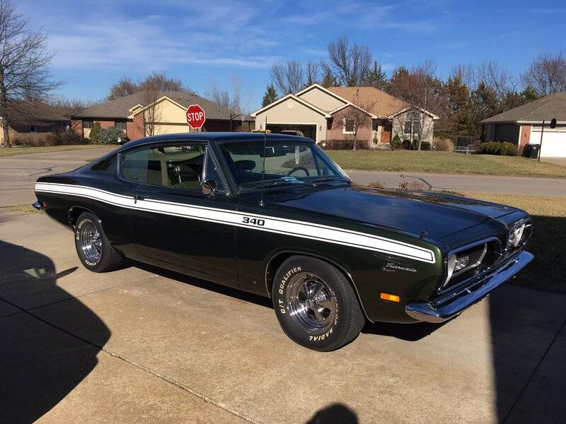

245/45-17x8 (25.68") front 275/40-17x9 (25.66) rear on my 'Cuda
Running the same 275/40-17 on the rear of the 69 Barracuda and the fronts will be something very close to the same diameter... like 245/45-17 (25.68") or 215/50-17 (25.46" diameter). Fronts are still TBD.
Close enough to a 135/80-17 (25.5") Temporary Spare diameter for me. That's what will be in the trunk of the Barracuda. It fits the tire well easy and lays below the trunk floor, so I can place a thin board in the trunk to cover the spare and it will lay flat. Will be upholstering or carpeting the trunk to look more like a new car trunk.
