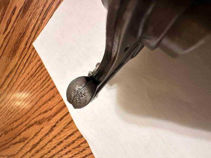

I finally have a couple photos and a little more info. So the mechanic is sure that this break is the result of over revving leading to valve float. I've certainly gone into the 5000s some and do tend to drive fairly aggressively. Mech wants to install a rev limiter, which feels sort of like training wheels, but maybe that's what I need. I did read an article about valve float that implied better springs would help guard against it. I'm pretty sure that the pistons, rods, springs, etc are all stock. Do I need to get high performance stuff to safely hit 5000-6000?

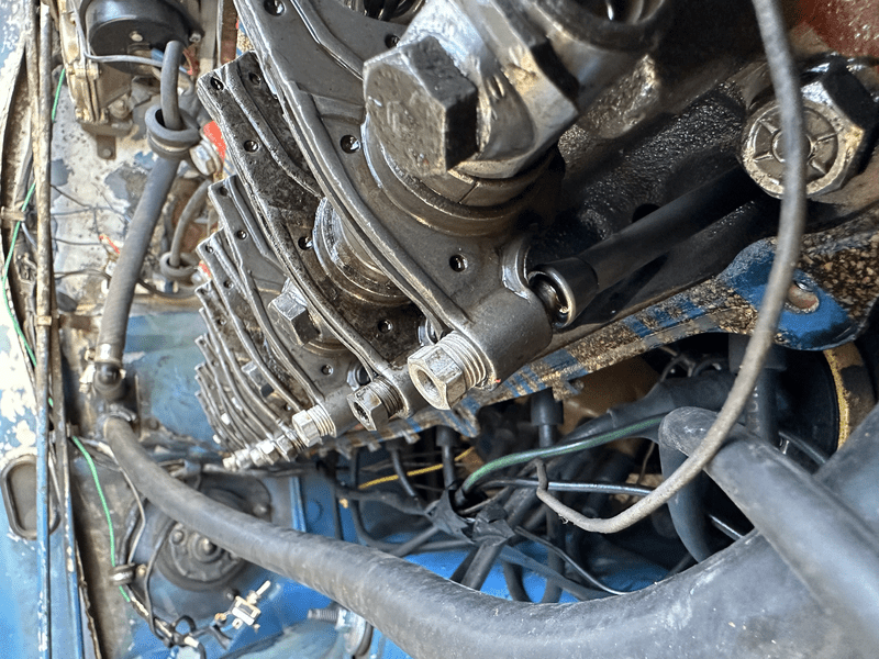

The adjuster is way out.
What does it look like at mid and max lift, pushrod hitting rocker?
There's wear where at the tip, pitting even.
The valve tip should have a * pattern on it from spinning at float.
What so the springs look like at full lift and are the valves all the same height?
That "break" looks suspicious to me.

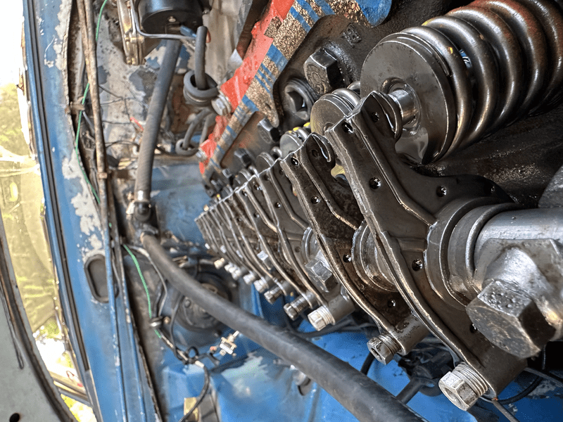

Here's a few more pics under the valve cover. Not sure why the're sideways, sorry. Valves are definitely not all at the same height but a lot of them are.

There is no chance of valve to piston contact in a 225 without serious compression mods and a LOT of valve lift, and floating the valves hard enough to drop-out a properly adjusted pushrod is nearly impossible, BULLSHIT..
1) Why is that rocker a dull gray color? Never ever saw a factory rocker that patina, dirty or clean, Evaporust treated? Were these things rusted to **** & heated with a torch to loosen them &/or the adjusters?
2) The pitting in the rocker tip is atrocious, was that rust pitting? Was it there before the "rebuild"?
3) You have yet to answer; *CAM/VALVES/SPRINGS*
Why is the adjuster for #2 intake so far out?

What pushrods are those? The pushrod cups look suspiciously large like they would hit the rocker arm at full lift.
