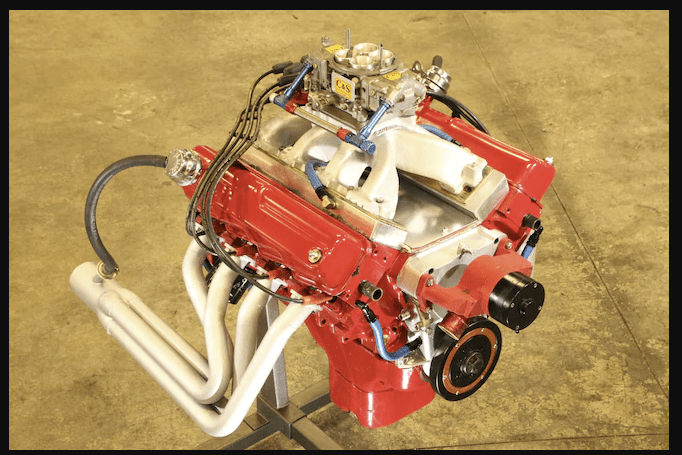

an LS intake can be made to fit a poly if you can believe that. Pretty close out of the box, just backfill the ports to match up.
yep. but not just back fill, the intake ports themselves have to be machined at the top to match up as well. But its very close. You all need an adapter plate to bolt it on and a coolant crossover system as well.
attached is a pic of the poly with an LS intake on it. note the adapter plates.

awesome pidc of the LS method- good luck shutting the hood

I would not like an inventory of poly manifolds with that LS work around available

The LS work around is very expensive to do. You don't save any money. A carb LS intake goes for nearly the same as a factory 4 barrel. Then you have the time and money involved in the expoxy and porting of the ports to line up. Then you have the custom adapter plate costs.
True but more choices for LS than Poly- unfortunately

No kit. And actually there's not a bunch of carb intakes for an LS, only a couple more options.
No one makes a kit. The intake is NOT a bolt on and HAS to be modified plus have the adapter plates. The LS intake isn't as wide and the bolt pattern is different. Thus the adapter plates.
