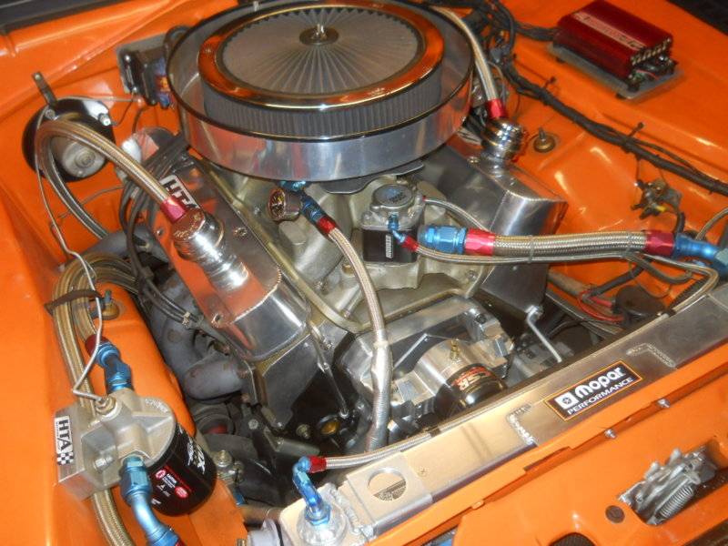

That filter is extra short compared to the shorter of the two OEM style. Use a thin oil or you will starve the motor at upper RPM's. Less filter hinders Flow through characteristics. Just a thought. I didn't have room so I went to a remote filter. You just haveto crank the motor with coil turned off until you see the mechanical gauge move.

I put remote filter mounts on just about everything... more oil in the system, oil cooling takes place, always a big filter can be used, etc. Make sure the lines and adapters are a full 1/2" ID all along the way and shield the lines from exhaust heat.
FWIW... I don't see oil pressure delays.. but I keep the remote filter down low.... that might make a difference.
