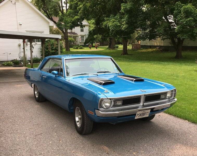

A shorter filter will be easier to install. I use the full length one and space is tight.
I might figure out a way to measure the angle, but for now Dicer's sounds pretty good.
Jaw Bone she looks to be a nice ride, you'll have a mighty fine car when you get finished. I do use the WIX 51515 filter, no issues.
