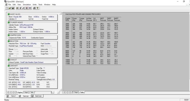

I'm re-using my cam for now:
.005 @ 292 dur
.050 @ 226 dur
.200 @ 141 dur
.328 x 1.6 = .525 lift
112 LSA
108 Intake CL
I found out I have a 3 keyway crank, any thoughts on the effect of advancing or retarding it 2 degrees being helpful?
I wouldn’t put it in in further ahead than 108. You may want to back it up to 110 but I’m not sure it would be worth it.
Did a DesktopDyno for fun. Current and future.
future cam I put a 110LSA 248 duration @.050 .535 lift 108CL
Cam installed on 112 ICL
Piston to wall set at .0045
Ring gap set .026 top .030 second.

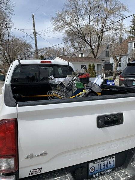

Just dragged a Ford 351M based stroker to the dyno .... made 430hp at 4700 rpm...yours should make more power.
Fell right in, I was surprised as well. I usually have to pull the hood. One less step!
Thanks!
Oh! OK. I agree, it’s a large part to install in the car on the engine. Did a 360 in a Duster two nights ago. I wouldn’t have guessed it would fit. No way no how. I do t know how he did it. We also have fresh paint, so that wasn’t getting in any danger that night!
