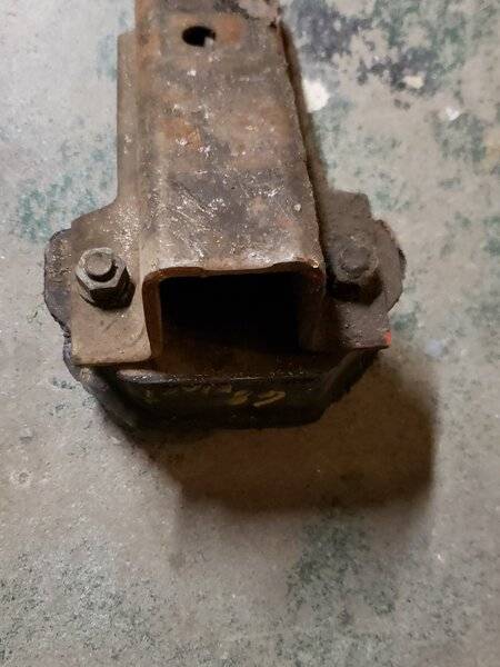

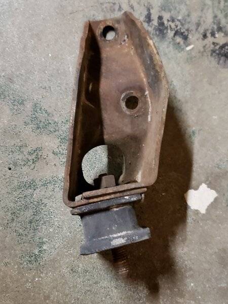

So I bought these today after finding out that my motor mount on the passenger side failed.
Does anyone have a picture of how the stock ones look? I really think that it's not that.
(70' duster, slant six, 225)
Thank you
Nope. The one in the pic in that link is a B or E body passenger side. The A body doesn't have the horizontal bolt loops. My 67 belvedere has the same one as in the pic.
