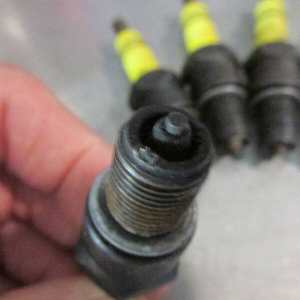

I got a head last week.
These Accel plugs were in it.
Any ideas why someone would do this?
To all of them?
Maybe they have a 100,000 volt system?
Poor man's E3?
Maybe they are storage plugs, all used up, clip off the lead, no confusion
I've seen them side gapped, but never like that. They were either running a LOT of ignition and could make the jump, OR they tried something stupid just to try it.
For that to work you'd need a serious ignition system. First, for it to work properly, those plugs should be non-resistor. Second, look into Plasma Discharge Ignition (or PDI for short).
