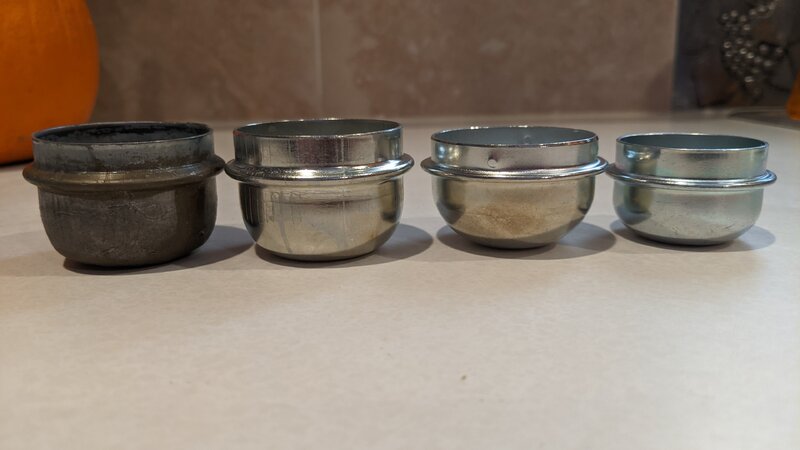

Left to right
OEM, Classic Ind Repo, 618-101, 13976
The OEM has seen its share of hammer blows so it's shape is not truly known.
The Classic Ind Repo is attractive and similarly shaped and sized to the OEM.
The Dorman 618-101 cap is a little shallower than the OEM or Classic Ind, but still fits even with the cotter pin bent up between the spindle and the cap.
The Dorman 13976 (618-100) is significantly smaller. The OD is too small for the 10" drum / disk. Maybe it fits the 9" drum?

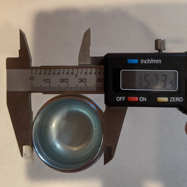

OD's
OEM
Classic Ind Repo
Dorman 618-101
The distance from the hub side of the stop to the outer end the cap.
OEM = 1.016"
Classic ind. repo MP500302 = 1.054"
Dorman 618-101 = 0.947"
Dorman 13976 (618-100) D = 0.793"

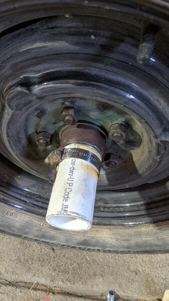

The Dorman 618-101 went on easy enough using a split PVC pipe, hose clamp, 2x4 and hammer.
No interference, and the cap does not feel like it will come off on its own.

The little one has to be for the 9" brakes. I must have had those on my old 65 Dart. I bought chrome ones to fit Dodge but nope.
I just bought the Dorman 13976 from rock auto because they said they guarantee they would fit. But they don’t even come close. Guess I’ll order the other one you tried.
That's why I bought it originally, it probably fits 9" brakes but not 10" or disk.
The 618-101 fits 10" disk or drum.
