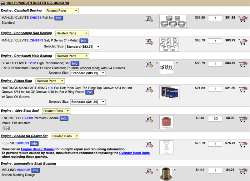

I need to probably sell off most if not all the standard bore rebuild kit I pieced together from rock auto .

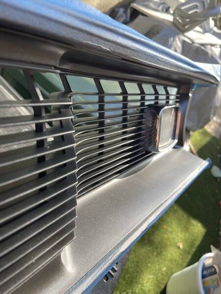

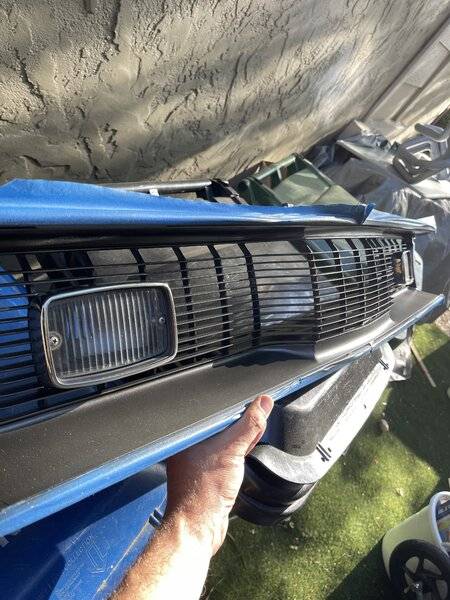

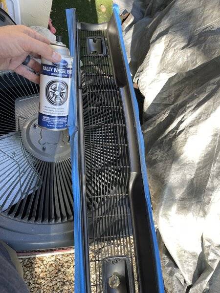

Got a chance to get the grill painted today. The bullitt anthracite wheels on the car will go well with the charcoal paint used on the grill to freshen things up. Have some fun ideas on the rest of the paint combinations in the engine bay that should turn out pretty nice

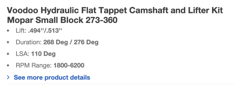

Ended up getting a solid deal on a Lunati 703 cam that'll be going in the block. It's about the right RPM range for my build and think it'll be a great matchup with the 750 carb, air gap intake and the 2300 stall converter (B&M) and the 3:73 gears. Also connecting with immengines.com on some assembled speedmaster heads.
