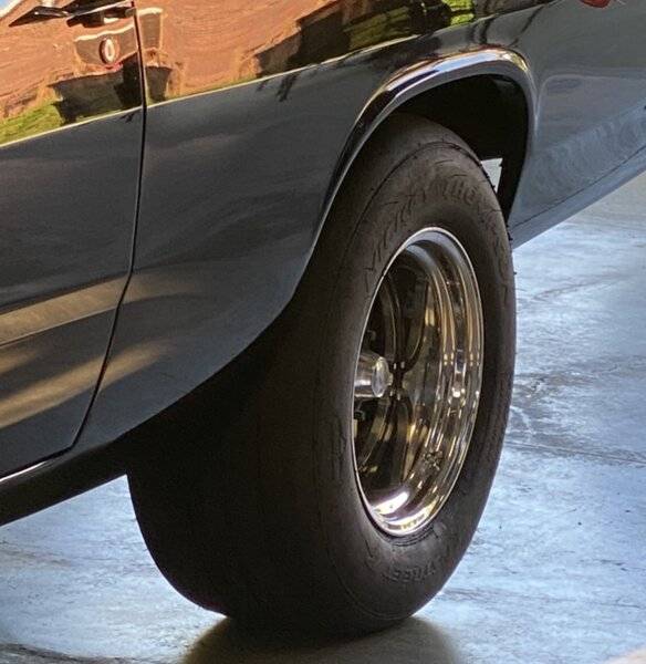

Pic for reference.
275/60-15 on 15 x 10 w/5.5” backspace.
I do have the springs moved in to the frame rails.
Ultimately giving a wider footprint than an 8” rim, exactly how much, I do not know.

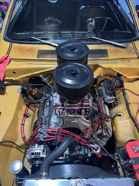

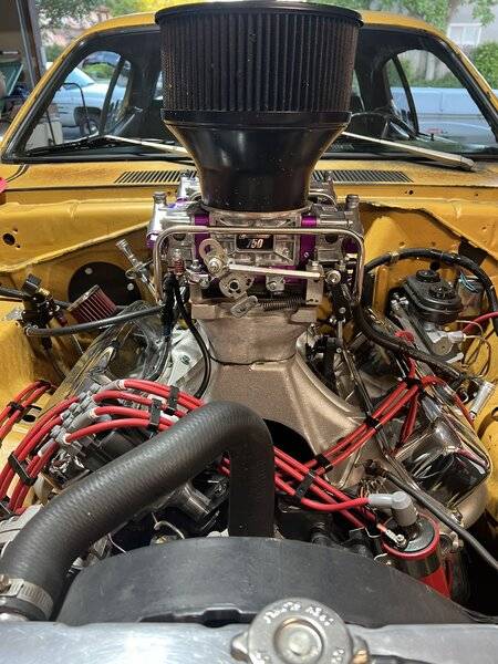

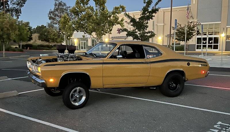

Thanks, let me start with saying that when I started this whole thing my goal was to build an obnoxious cruiser that could be driven all day long. That IMO has been accomplished. That being said, every cruise in, show, or cars and coffee I attend the question is asked, “What does it run?” The answer is “I don’t know, it’s never been on the track.” So I’m preparing to put it on the track and find out.
The particulars:
71 Duster
440 factory forged bottom end
Stealth aluminum heads
Comp Xe275hl cam 1.6 rockers and B3 geometry correction.
Weiand tunnel ram w/2 750dp
727 w/3000 stall
Dana 60 w/3.23 gears

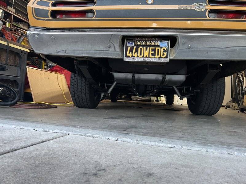

And yes it has a straight axle with a 3” drop.
Super fun to drive and cruise.
Just purchased the tires, and the 10” wheels are on the way. I have a few other things I want to square away then it’s off to the track to find out what it can do.

F’in right!!! That’s an awesome Duster!
Let ‘er rip!
