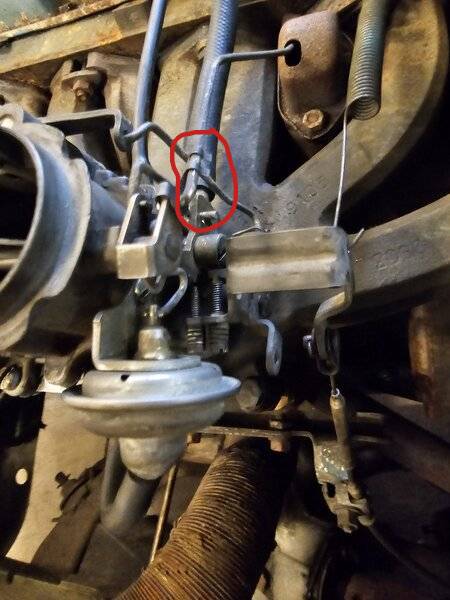

Remove the rod circled in red. That's the offender. That rod installs on the choke, not the throttle lever.
Sooo...it was the throttle linkage cable. Now, I just have to figure wheter to replace the cable or get it unstuck.
Thanks for the help everybody!
Edit: Adjusted the throttle cable from this bolt and now the problem is fixed.
I think that picture is a bit deceiving at first glance. I thought you were correct, but a real close look shows it is hooked up to the choke. I think it's correct. Or I'm just misunderstanding completely.
I think you're right!
