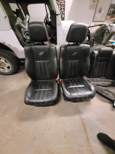

I just purchased these Chrysler 300S seats for less than I could buy supplies to recover my current seats. I know I have seen posts somewhere about doing this, but I cannot find them anywhere?
Has anyone ever used 300,Charger,Challenger seats in their A body? I know the front seats will fit, butI am hoping can make the back seat work too.

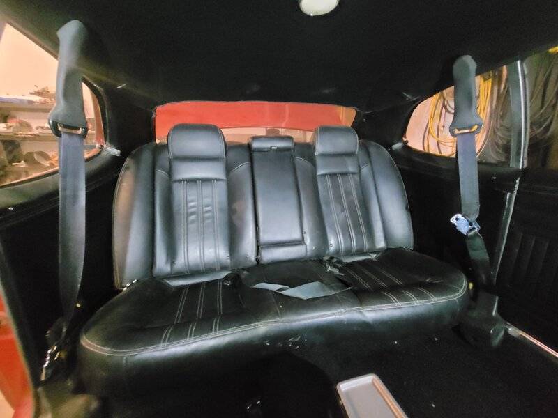

Well it looks like it will work really well! These are just sitting in there, but they fit like a glove! I'll share more as I get further along.
Cley
Back seats are in for good. They are a 2 piece seat since in the 300 they fold down in 2 different sections so I used a couple pieces of 1/8" x 3/4" aluminum flat stock at 4' long to hold them together. These pieces also hang the seats from the stock upper hangers and bolt them to the rear fire wall. In the second photo it shows the gap between the seat bottom and the side of the car. I will cut a piece of foam to fit there and wrap it in black vinyl.

Fronts are in. They sit high, even after I shaved the factory bench seat mounting hump on the floor. I am 6' tall and they are fine for me. Much taller and they would be uncomfortable. The seats themselves are very nice! I am super happy I chose them.
