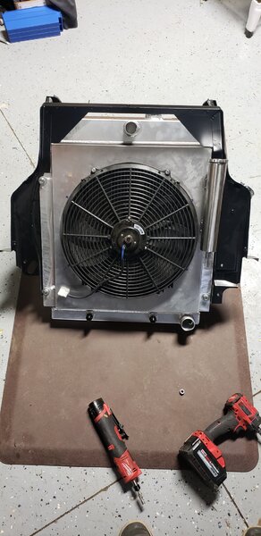

Brother is struggling with radiator hoses for his 6.4 swap, running a Cold Case swap radiator with PS inlet and outlet.
What has been used to get them to connect without kinking? Part numbers would be great.

The Cold Case radiator top connection is towards the center of the car, maybe 6" closer to the centerline than an LX radiator. In the end, the top connection is almost lined right up with the thermostat on the motor. So I don't think an LX one would work.
The bottom one is about the same where they line up pretty close and make it difficult to get to fit.

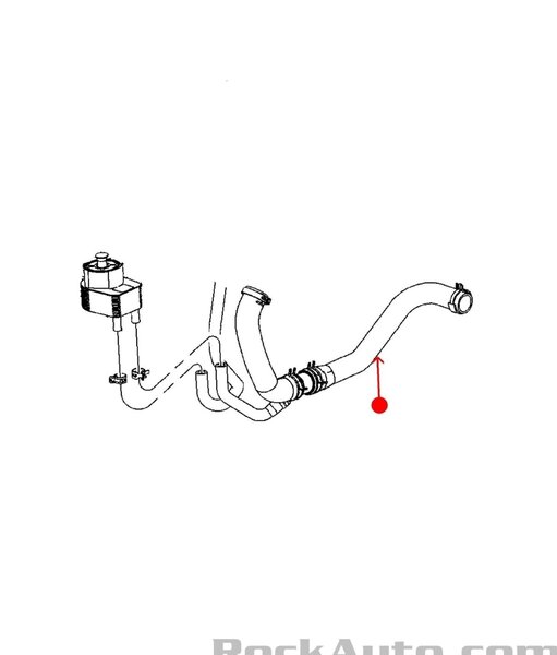

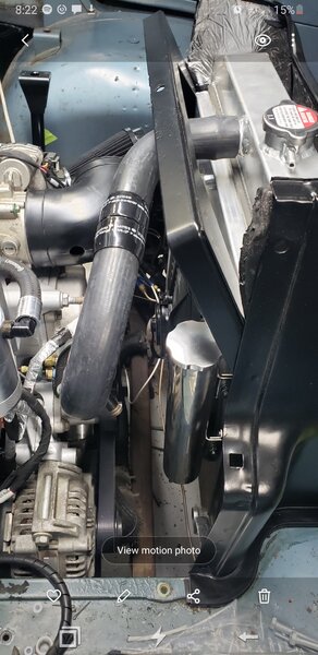

I just used what I had off the donor car. The lower hose was a stock hose for an oil cooler setup. I cut into 3 pieces.. Section before splice, the splice and section after the splice. I just kept trimming the rubber until the pieces made what I needed, using the oil cooler section as the splice. Unfortunately I don't have a good Pic of the hose installed.. Just this teaser pic
If you don't have an oil cooler, just grab a splice off Amazon.. 10 bucks. Also, if you've never tried the gates heat shrink clamps, they're awesome
